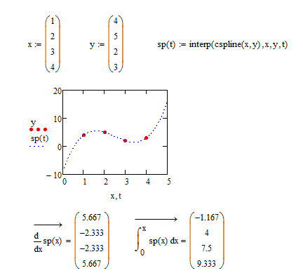

Yes, it is. For this, and for the issues in the extreme of the interpolation intervals and the importance of that in solve differential equations I write this:
Derivative and integral for regular cubic splines.
di cspline test.sm (86.48 KiB) downloaded 1506 time(s).

#5 Posted: 4/5/2019 12:31:29 AM
On that point, Mathcad ODEsolve is based on 'lspline'.
Remember it was explored in the Mathsoft Collaboratory.
Thanks, most profitable, just finished converting the code
to normal variable names ...
in the last CS.V(X,Y) ... 'c' created red, thus replaced by 'q'.
At the time I checked those splines, Mathcad code is same as Matlab.
Matlab tutorial was about 10 pages long ending to same Mathcad tridiagonal.
Sanity was checked Mathematica 4.0. Those basic codes were borrowed
from the big ACM library. All same as Smath cinterp.
Radovan Omorjan 4/5/2019 4:35:00 AM

Some notes about Radovan's sadness :-(
CinterpQuickDiffInt.sm (30.17 KiB) downloaded 1302 time(s).

#7 Posted: 4/5/2019 1:48:01 PM
True: Smath "cinterp" is not the best companion and not recognized
vs other CAS. As demonstrated in the attached, not as accurate.
Spline0 l_p_cspline Dspline,Cumul Copy.sm (83.66 KiB) downloaded 1308 time(s).
