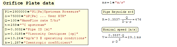

Just for giggles I will do my next calcbook unitless and will see what sort of feedback I will get. ... Assume a spherical cow in a vacuum... Wait! its a coccus with horns and a tail!!!
Jean, you concept of unitless math is very true; however, math applied usually asks for a some sort of a frame of reference, which is given to us by the units.

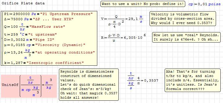

#4 Posted: 4/8/2016 10:39:14 PM
By the way, your Reynolds formula, being physically incorrect, also doesn't compensate for using centipoises.
So you are reasoning, that engineers should:
- substitute their understanding of a physics of what they work with, with some authorized magic formulas,
- blindly believe that those formulas are correct?
Let me link here an example article that discusses one Russian standard where gas hydraulic formulas are given. Unfortunately, it's in Russian. It discusses the incorrectness of that formulas, and the causes that had lead to that incorrectness. Among them are using "magic coefficients" that stem from using values in specific nonstandard units (like your cp, or t/hr), "masking" real physic laws with "convenient" formulas (they are "convenient" only when you need to use paper for calculations), and arbitrary rounding of those coefficients. Contemporary software is capable of taking your favorite units, and do robust translation to standard units so that you only have to know physics, without having to remember useless coefficients.
Having those magic formulas in standards is simply remnants of the era when you had not softwares that allow you to express physical laws in their natural ways, when you had to use such "convenience" formulas just to be able to do maths in a timely fashion. And they do have errors in them, because of that. Reasoning like yours would just prevent fixing those standards to contain pure physics instead of that crap.
I know many engineers that don't understand the underlying physics and just use those formulas as "black boxes" to get answers. That leads to improper use of the formulas, just because they cannot see the range of applicatibility of them! And it's difficult to catch errors in their complex calculations, because of those cryptic formulas.
Actually, your point here eludes from my understanding. From what I see, it looks exactly analogous to this reasoning:
"Let's take some common words: "Number of minutes". Now, let's "multiply" (mix) them by some other word: "min". Let's see result: "Nmuimnbmeirn moifn mmiinnmuitnemsi". Utter garbage! Never use units!"
Using units properly in math software isn't taking a number that you made unitless explicitly, and trying to see its absent units.
So what? You have a job that requires you to do dimensionless maths. Does that mean that each must do same regardless of their circumstances?

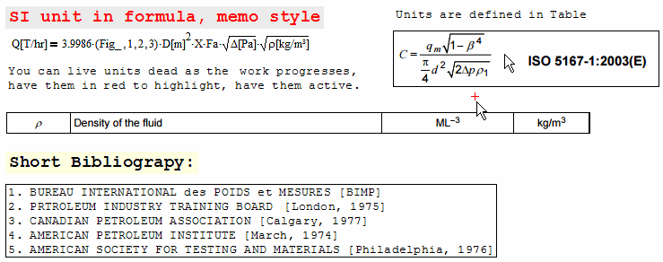

0.3537 is like a universal constant in the SI t/hr in Process control fluid mechanics.
The all matter is if unit system is proftable use it and abuse reading as you wish.
Don't fill air plane in lbs instead of kg as it happened [miracle, nobody got killed].
Just make your client happy unit/unitless. Wise to know both routes.
Don't forget that most decision makers are old timers like myself, using references
[books, standards ...] that use unitless maths. All your blue stuff would make many
laugh, wondering about the burden to cross check results.

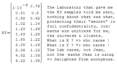

You right Mike: we are saying the same thing, in different words.
Not a joke, the day I received a 48" butterfly valve to be installed in a 4" pipe:
all the monkeys went down the three to admire the new born "Strümpfchen" .
