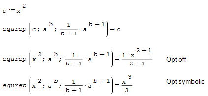

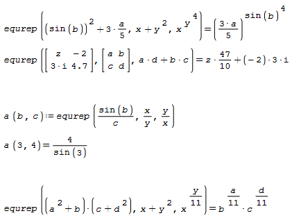

This time I've spent many time on improvements of symbolic engine to make it more safe and predictable.
To show some results I've made available equrep(3) function which is hidden from auto-completion list and other places. It demonstrates possibilities to manipulate with complex structure of different equations. I'm not sure if anyone interested in this function at all, but under the hood it is used almost for every calculation in the program.
This function has three arguments:
- First is a given equation (anything to manipulate with);
- Second is an input for manipulation rule;
- Third is an output of manipulation rule.
In other words it allows to apply some manipulation (described in two last arguments) to an equation (from the first argument).
Some examples:
Do not forget to set Optimization=None if you want to see exact result without any extra numeric or symbolic optimization.
3 users liked this post

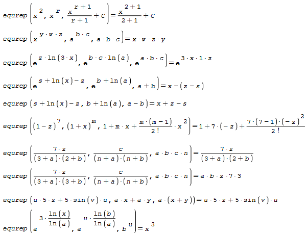

looks promising. Maybe, this might simplify restructuring of terms inside plugins.
As it seems, the function does not preprocess it's first argument. The definition of c isn't during the call of eqnrep when running the sheet step by step.
I see that the structure patterns should be unevaluated otherwise you would rely on having the variables therein being undefined in the sheet.
How about a function or a flag enforcing preprocessing?
equrep.sm (5.56 KiB) downloaded 1587 time(s).
frapuano 11/11/2019 12:01:00 PM
#4 Posted: 11/8/2019 8:31:03 AM
1,364 likes in 2,281 posts.
Actually an equrep function with preprocessing can be made:

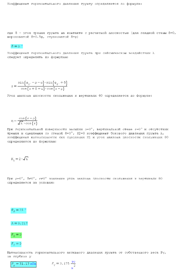

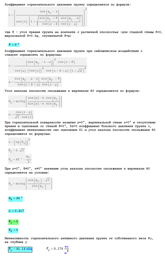

genf
genf
6 likes in 72 posts.
С некоторых пор возникла проблема непечати некоторых элементов.
Расчеты делаю в Вашей программе, затем вывожу на печать в формат PNG и вставляю результат в Word.
Возникает проблема с блоками, отмеченных как "Запретить вычисление". Раньше над ними (в правом верхнем углу) был прямоугольник, сейчас они отмечены серым фоном. А с ним как раз и беда.
Что можно сделать?
На просмотре так:
Show Spoiler
На печати так:
Show Spoiler
Как видно не все блоки напечатаны, причем некоторые из нерасчетных были всё же напечатаны.
Ранее (когда не было фона) таких проблем не возникало.
Для печати использую виртуальный принтер pdf24.
Стандартный экспорт в PNG формат не делит на страницы, так бы им пользовался (там кстати проблем нет).
Пока вышел из ситуации с помощью скриншотов. Костыль конечно, но ничего не поделать.

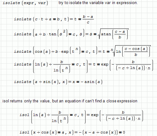

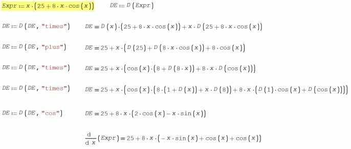

#6 Posted: 11/11/2019 7:10:22 AM
1,139 likes in 1,805 posts.

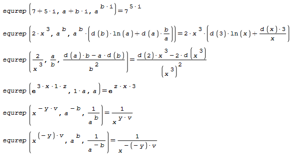

Hi. An application for equrep: step by step derivatives.
D.sm (14.41 KiB) downloaded 1561 time(s).
frapuano 11/11/2019 12:01:00 PM, sergio 11/14/2019 9:19:00 AM
#7 Posted: 11/14/2019 4:04:00 AM
Another.
isol.sm (42.38 KiB) downloaded 1598 time(s).
#8 Posted: 11/14/2019 7:55:59 PM
I don't understand the maple fake [isol].
Already such a superb companion to Smath.

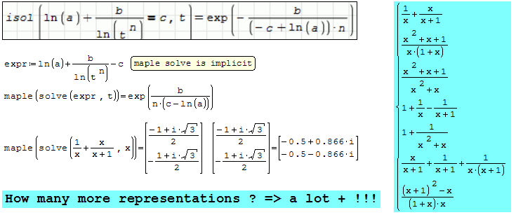

I like native. I wish items like Writer Region would go native too.

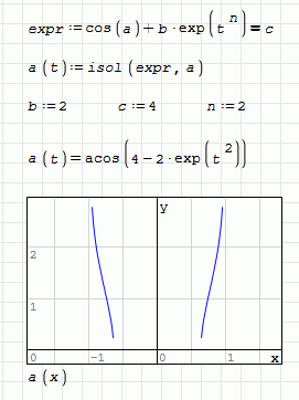

Alvaro or Jean,

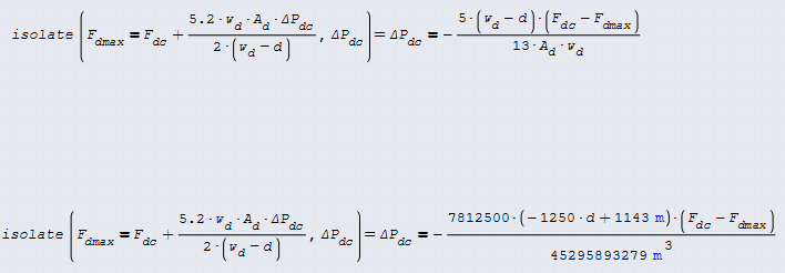

When Isolating in either the snippet or Maple, is there a way to force the symbolic engine? I tried using after some of the variables were defined (Yes, I used CTRL+=) and they both work prior to variable assignments. The issue is that many times, we define the variables and further down the calculation shows the equation ... that I'd like to manipulate. I tried setting optimization to none and symbolic, both failed

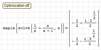

It’s better to turn off optimization to see the native maple answer.

Alvaro or Jean,
Hi ElSid. I know that SMath carry the definitions instead the values, and with symbolics there are not an eval equivalent. But without an specific example, this is what I get

Ruben Sidranski
Ruben Sidranski
17 likes in 465 posts.
I forgot the screenshot due to a meeting!
The space between the equations has some variables "defined". Maybe what I'm looking for is a feature request. I have the same issue with Maple plugin.
Essentially, I'm transferring a hand calculation and wanted to show all the steps in order. It does not make sense to isolate and manipulate an equation that is not used for 3 pages ... it's out of sequence and out of context
This screenshot is valid for both optimization=symbolic and none

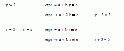

#18 Posted: 11/21/2019 6:22:44 PM
... Maybe what I'm looking for is a feature request. I have the same issue with Maple plugin. ...
Hi ElSid. I guess that what you want is the 'x:=x' mathcad feature, which hide the value of x for the symbolic processor, but not for the numeric one. This is a mathcad 11 screenshot

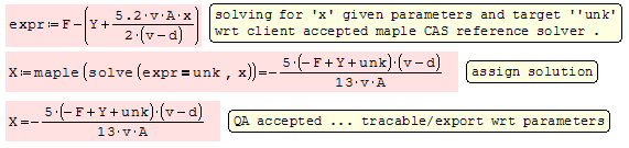

#19 Posted: 11/22/2019 1:07:21 AM
± You mentioned 'Native Smath'
maple is not a plugin from Insert Menu,
rather resident from f(x) menu.
No need to scratch the right ear with the left hand.
Further: your stuff must be tracable/accepted/visible.
