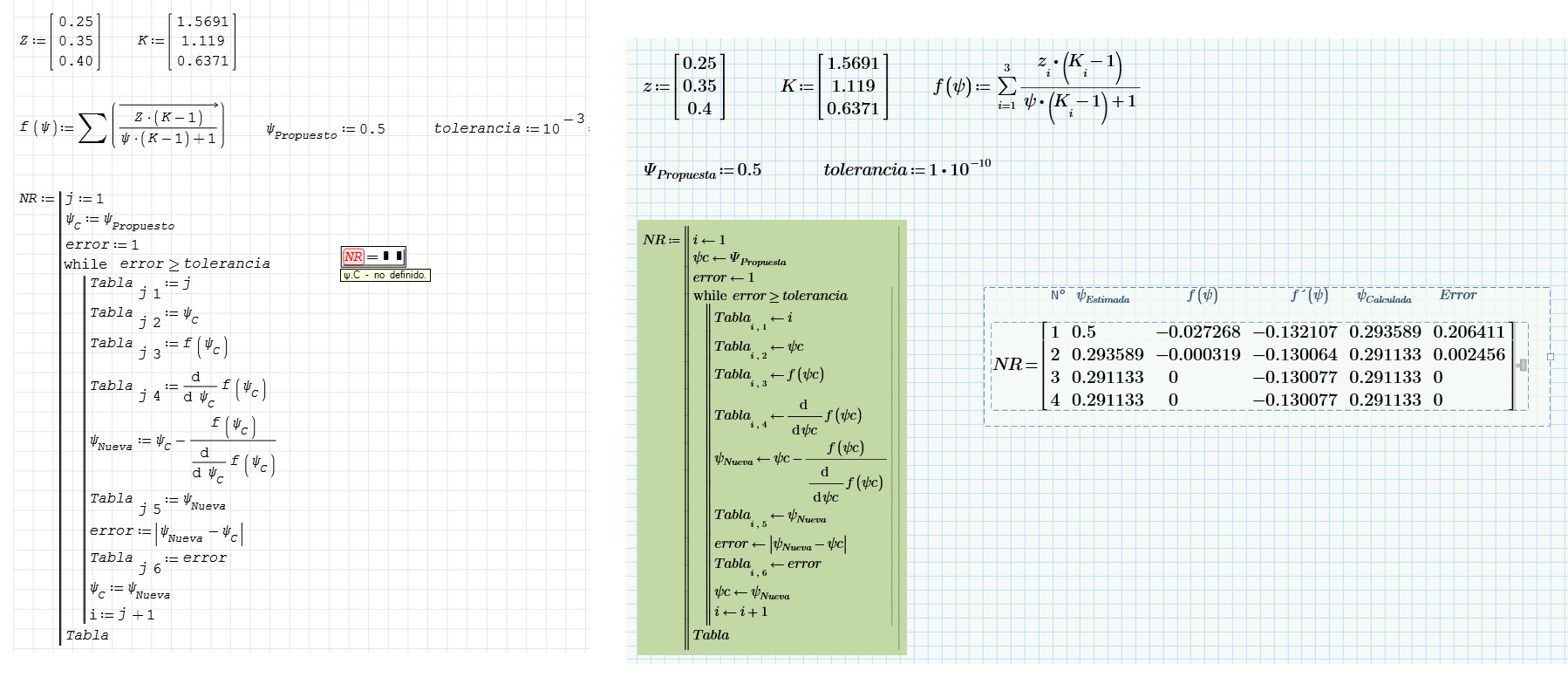

How can I do this loop while?
what am I doing wrong?
NR.sm (8.06 KiB) downloaded 1017 time(s).

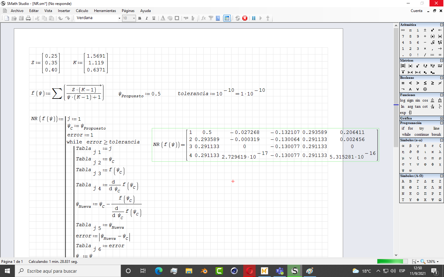

I think it already came out, but how do I make the numbers that are almost 0 not appear as 2.72 * 10 ^ -17?

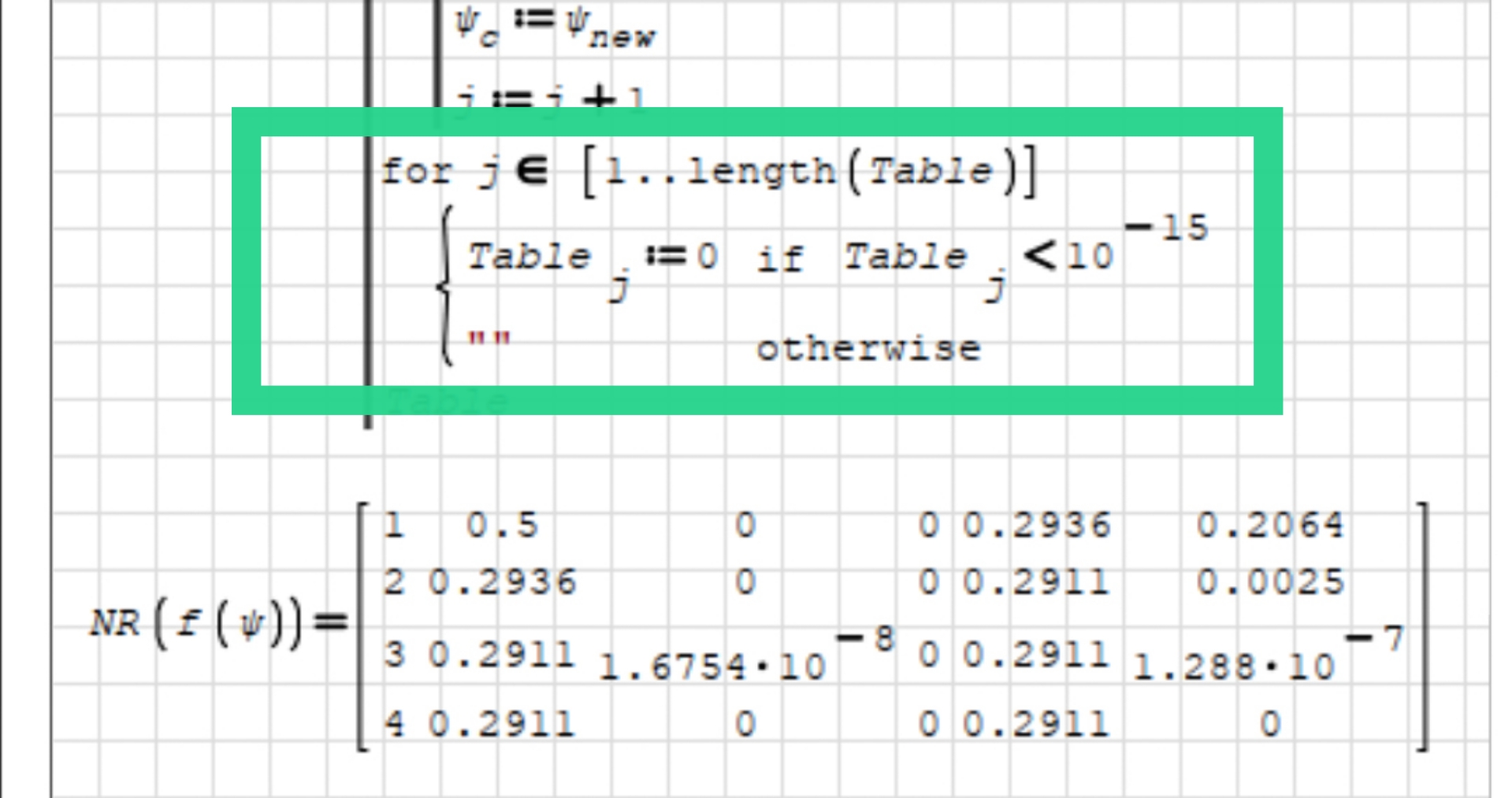

#3 Posted: 9/11/2021 3:23:39 PM
598 likes in 1,379 posts.
Add a check for every element if they are lower than something.
And if they are, make them zero.

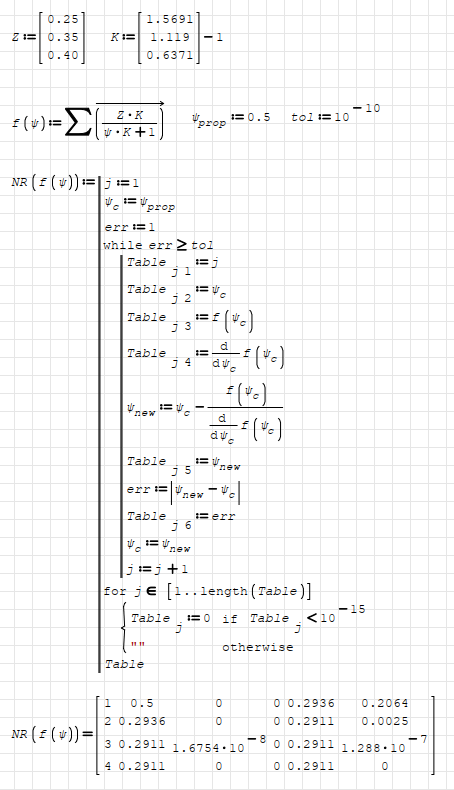

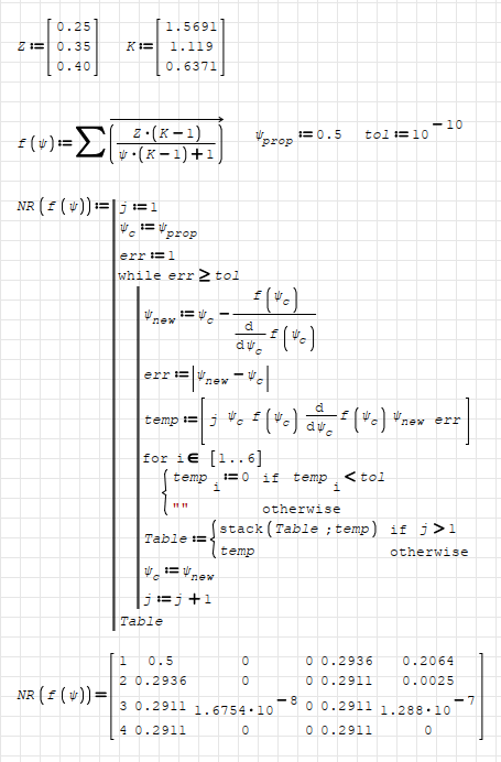

#5 Posted: 9/11/2021 4:09:46 PM
what function does this have?
That is cases(), it is in Custom Functions plugin.
I would prefer to write your algorithm like attached.
It is just my preference by the way.
NR_r1.sm (9.6 KiB) downloaded 1010 time(s).
