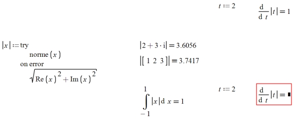

For only numerical procedures it seems that you can redefine abs(x) in this way:
Notice that this don't works for derivatives. It could be a good idea typesetting norme(x) as ||x|| (double bar).
sergio 9/27/2020 2:30:00 PM
