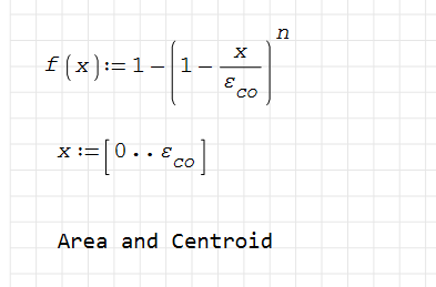

#1 Posted: 7/11/2023 2:40:19 AM
soomoon
soomoon
1 likes in 42 posts.
How to find area and centroid
question_20230711.sm (2.88 KiB) downloaded 1444 time(s).

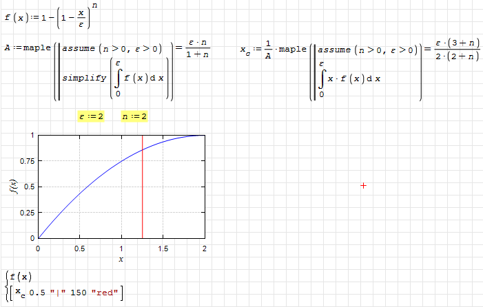

#2 Posted: 7/11/2023 4:59:38 AM
1,362 likes in 2,276 posts.
Ac.sm (6.17 KiB) downloaded 1411 time(s).

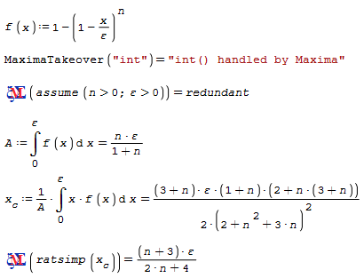

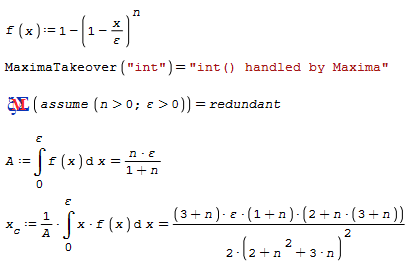

#5 Posted: 7/11/2023 9:17:41 AM
1,558 likes in 1,868 posts.
Ac (uni).sm (8.4 KiB) downloaded 1449 time(s).
#6 Posted: 7/11/2023 9:40:34 AM
Maxima is a bit lazy with simplification...
Ac.sm (7.08 KiB) downloaded 1401 time(s).

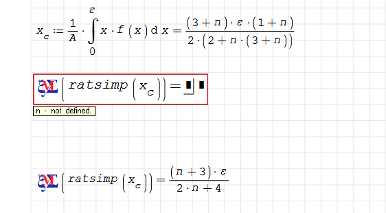

#7 Posted: 7/13/2023 2:39:23 AM
soomoon
soomoon
why can't i do right that?
what's the problem?
