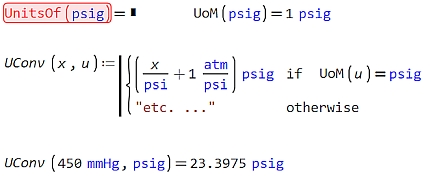

As workaround you can define your own convert function for show pressures, given that you know if a pressure x is absolute or gage:
Notice that UnitsOf returns an error for unknows units, but UoM works. Also I'm not prety sure if if that convertions is correct, but it's justo for show the idea about how to show abs or gauge pressures.

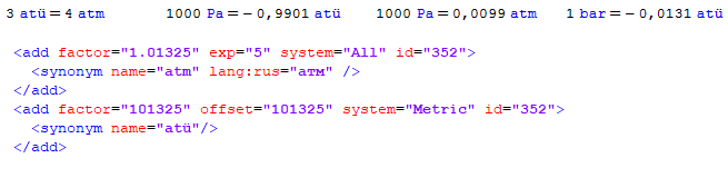

You might try to hack the file "units.xml" in folder "entries" in your SMath installation directory.
There is a section Non-linear units. Try to understand the logic of how temperature units are defined and extend that to pressure units. Note that the id-attributes refer to line numbers in the language file (in lang\Text_xxx.lang)
Beware that sheets based on non-standard SMath configurations aren't portable. Thus, as soon as you are happy with your hack, you should ask for integration into the standard distribution.
I once added some special units to the file and integrated it in my portable distribution (see link in the signature). Yet these units weren't essential, so I dropped them later in order to limit the maintenance effort of the portable distribution.

I have tried making some initial changes in Units.xml to add a definition block for barg and corresponding additions at the end of Text_ENG.lang, but any change to either file leaves SMath unable to load. Is there some other detail, come other file cross-reference, I need to address as well?
I think you have to leave the language files untouched. The length of the file and the replacement handling is probably hardwired at compile-time.
This implies that you don't get a correct description in the insert units dialog and in the dynamic assistant.
Yet you can define and use the units as you described in the topic starter post.
Here, I demonstrate this with the german atü unit (Atmosphere Overpressure/Überdruck)
Once you are happy with your definitions, ask the developers to add these units by default. This has happened in the past, so there is a chance.
BTW, I'd expect many new users to fail with correct usage of such units as they aren't aware of the difference between absolute and difference units, much like the frequently popping up questions on temperature and temperature differences.
Page1.sm (12.09 KiB) downloaded 1842 time(s).
Units.zip (4.53 KiB) downloaded 526 time(s).
