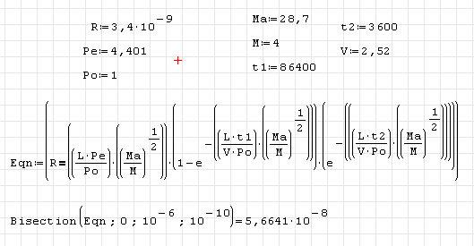

I am new to SMath. So far it's great I am impressed. I've been searching the forums for a solution to my situation. I haven't found anything yet.
Can someone educate me on this?
Any help would be greatly appreciated.
Here's a screenshot:
I know R from our mass spec measurements. I need to go back and find L (the actual leak rate of the device). There is no way to solve for L directly.
The answer for R=3.4*10^-9, L=5.612*10^-8... this is from a lot of work on my TI-85... I'm not 100% sure it's right...

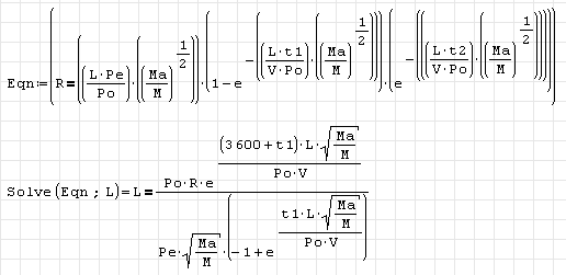

You might try the Maxima-Plugin

Thanks, I'm not sure this solves my problem. This looks like it rearranged the equation, but did not solve for L.

You are right, I did not really inspect the result, sorry for that. Here is another proposal.
#6 Posted: 1/18/2014 4:22:15 AM
Martin suggests that you try to find L symbolically. Maxima returns L=f(L) which means that the function is nonlinear. Then you will go for a numerical solution. Numerical equations could be tricky. The best is first to try to plot it - to see the possible guess values and to see if there might be more solutions. See the pictures with the Maxima's L=f(L) rearanged equation and with your original (try to avoid so many braces - it is not needed). The second picture is with your original equation. This one is much more problematic for numerical solving. It seems that you need quite good guess value to get the second solution or you are going to get some value around zero, which is another solution (see the pictures). If you try to rearrange the eqaution is some other way, you might get no solution at all.
I do not know if this solution even have sense to you. There is another problem.

#7 Posted: 1/18/2014 7:46:10 AM
1,361 likes in 2,275 posts.
The equation has two solutions. Plotting the function f(L) is not very easy in the built-in plot region. Here is an example for how this can be done using the Maxima-Plugin. Not user-friendly either, but full control provided.
Leak_draw.sm (16.45 KiB) downloaded 1385 time(s).

This awesome. I know for certain that the solution for L when R= 3.4x10^-9, is 5.614x10^-8.
So it appears there are many ways to get there. This is the first time I've used the program and I'm excited about all the possibilities. I'm going to try them all just to learn some more.
Thanks again!

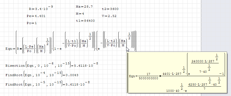

#9 Posted: 1/18/2014 8:34:03 AM
rattler1975
rattler1975
0 likes in 13 posts.
I keep getting "L - not defined." Any suggestions?
I get "failed to load" error... any ideas?
#11 Posted: 1/18/2014 9:59:23 AM
Martin's example works perfectly for me. A nice one to see the possibility of Maxima and draw package in SMath. Thank you Martin
I suppose that here is the problem with Maxima plugin. Not loaded correctly or not installed at all.
@rattler1975 - did you install Maxima itself and the Maxima plugin anyway? When you tried to open these files from me and Martin, is there any error about missing plugins.? If you do not know how to use it and you need it - just see the Martin's Handbook. There you will also find how to solve nonlinear equations as well (with or without Maxima).

For the Leak_draw.sm file, when I open the Bisection(Eqn,0,10^-6,10^-15) part is red and says, "L-not defined." Same for FindRoot.
Then for Maxima(load(draw)) it says, "failed to load, C:/Maxima-5.31.2/share/maxima/5.31.2/share/draw/draw.lisp - an error. To debut this try: debugmode(true):"
I've run the "maximacontrol(settings)" and it finds the maxima.bat file. It appears to be working. So I am now confused.
#13 Posted: 1/18/2014 10:17:06 AM
Here is the part of the Martin's file. Do you have problems here?
By the way, Bisection() and FindRoot() are not part of Maxima plugin. Moreover, I have no idea why do you have the "L-not defined" error here. Actually, L should not be defined here if you want to find the solution for L.
EDIT: Ah yes, I missed one of your post before. It seems that the NonlinearSolvers plugin is not instaleed correctly. NonlinearSolvers from Plugins Galery can be installed when you used this password NonlinearSolvers - see (this post)
L not defined: I can just guess. If it happens with Solve, then possibly you use numeric optimization when displaying results. In the context menu (right mouse button) of the math region, you find an item "Optimization". This is ususlly set to "numeric", meaning that SMath Studio tries to display numeric values and eventually units of measurement.
Solve() returns the result as boolean equations "variable = value". This requires setting optimization to "symbolic" or "none" for proper display.
As to the load problem: It is essential that you use Maxima 5.31.1-1 instead of 5.31.2. I have no idea why, but that is the solution.
BTW, if you use the portable SMath distribution (see my signature), then you have most plugins pre-installed and access to a built-in handbook (Help> Reference book) with over 500 interlinked SMath sheets, some of them covering Maxima features.
Currently, I am updating the german pdf handbook (new chapter on SMath with Maxima including graphics examples). It might be useful, even if you do not speak german.
