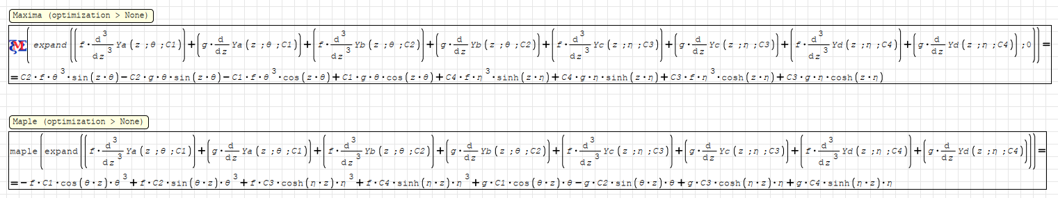

Good morning to all,
I'm checking some symbolic hand calculation and getting used (again, after a stop) with symbolic calculations in SMath.
And I've encountered some "strange" behaviors : it seems that, depending on how the same function (to be evalueted symbolically),
is written, the result is the one expected or not....
I'd not say, in a first instance, it is a bug: maybe I'm violating something implemented
in SMath...please, have a look to the attached file.
Any suggestion is more than welcome!
Thanks

Thanks OVERLORD!
"Maple plugin" works fine and really quickly!
Some more details:
--> I directly typed "expand"...so, I wonder if there is a list of commands (such as "expand") somewhere...
In case yes, here, specifically, I'd be interested to simplify / factor out (in Mathcad this function si called "simplify") the symbolic result
--> Enlarging the point of view.... As far as I can understand the Maple plugin use the Maple calculation engine
(what is free at least)...If so do you think it can be used elsewhere? I'd be particularely interested in functions of 1 variable
generated from matrices (4x4 and higher) multiplication in chaine...If Maple engine could speed up calculations it would be great..
Clearly I can create a new post with attached the specific spreadsheet....
About "Maxima plugin": I cannot find nor a plugin Maxima nor a function....some indications more?
Many thanks again & best regards

See https://nbn-resolving.org/urn:nbn:de:kobv:522-opus4-29497 for instructions and reference for the Maxima plugin.

Dear MARTIN,
thank you very much for your reply!
Indeed, I downloaded both the plugin and Maxima.
And it works fine for the specific issue I highlighted.
I had a look also to your document on Maxima.
Going further (as for Overlord and Maple plugin) I'd like to know if (and how...) Maxima could
improve the time of calculation of a function derived from matrices multiplications.
The function is the characteristic equation of a transfer matrix for a non-uniform beam...better, the transfer
matrix of a beam made by multiple, uniform beams, different each other (multi-stepped beam)....

#6 Posted: 1/23/2026 9:46:18 AM
An include file is missing, so I can't run your worksheet. Also make sure that all your math regions are set to numerical optimization.

#8 Posted: 3/17/2026 6:57:57 AM
Symbolic calculations in SMath can definitely feel like a bit of an art form sometimes. I noticed the same 'unexpected behavior' in similar builds. Are you using the native engine or a specific plugin for this? Usually, re-ordering the definitions helps, but it’s strange that the same function gives different results.

Dear NORRAH_CASPER,
really sorry for the very late answer.
In facts I'm, now, using only Maxima plugin that works finely.
Never encountered again the issue (found with native engine) I highlighted at the beginning of this exchange. Maybe, I should also resume Maple plugin
in order to gauge speed of calculation.
Last but not least, it's possible that the issue with native engine is solved with latest available free version of SMath; but test still not done.
