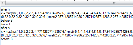

With your "if" statement, a trace() check relative to the iter variable return this:
there are no steps incremention, both "if" and "else" statements are not evaluated, but while cycle 3 times o_o
if you put a fake statement (f.e. 3<1) the if/else evaluation work:
if you look the trace() output you can see that in the third loop there is a "before B" but not an "after B", so I think the 2nd issue is in that if/else statement

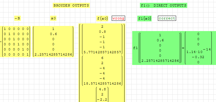

Here is the the screenshot of the example which is working and there is no problem about it.
As one can see, the h-value (which is inside the if(),btw.) is calculated as a vector of numbers - as it should be expected.
On the other hand, when using the problematic example:
As one can see, the h-vector is a nested matrix???. I can not figure out why is this happening. On the other hand, if we do that outside the function everything is fine, h-vector is a vector of numbers as it should be. Therefor, if() got confused and everything else broke down.
Here is the file with both examples typeconversionerror-1.sm
seems that the issue it's the different evaluation of f1(x0) (directly, outside the Broyden function) and f(x0) (indirectly, inside the Broyden function)

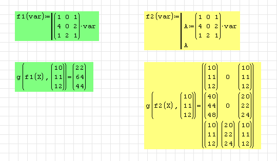

see this file, and enable or disable evaluations of f1() to see three different behaviors (optimization indipendent) 0.94_arrays%20bug.sm.zip
all differences are in A definition (assigned multiplier / variable multiplier / variable multiplier with operations)

Wrotebug found and reproduced! (I think)
see this file, and enable or disable evalutations of f1() to see three different behaviors (optimization indipendent)
I think that the bug is in "line" definition of function.
Look into this file, where I define f(x) without "line": 0.9_line_bug.sm
All answers are ok.

Hi oscar,
you're right, the bug involve matrix products defined inside lines(), when the products are stored inside local variables
I think now Andrey has enough elements to try to solve this issue
