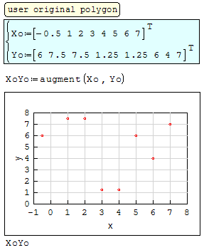

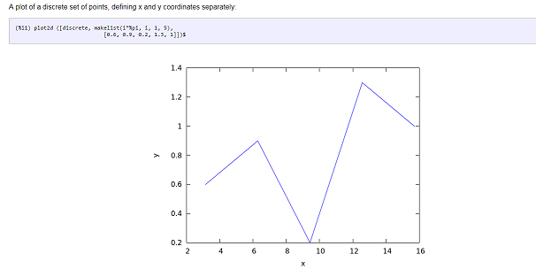

Is there a way to plot discrete data using Draw2D function. I see there is a method of plotting by defining points within maxima using method shown below.
I've been able to plot just points themselves using the points() function. But haven't been able to figure out how to get the connecting lines without defining explicit functions.

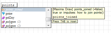

use the option points_joined=true

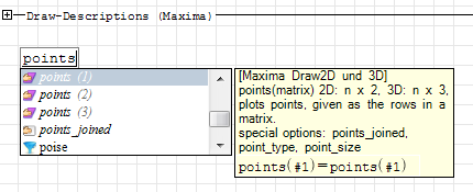

The snippet "Draw-descriptions" provides help texts for the graphics objects and options.
See the Handbuch for examples.
