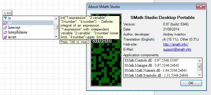

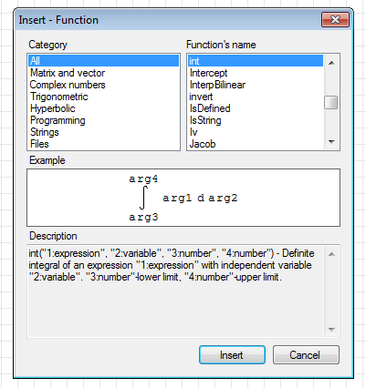

  • 0.97.5346 without Maxima Plugin:

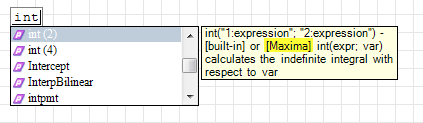

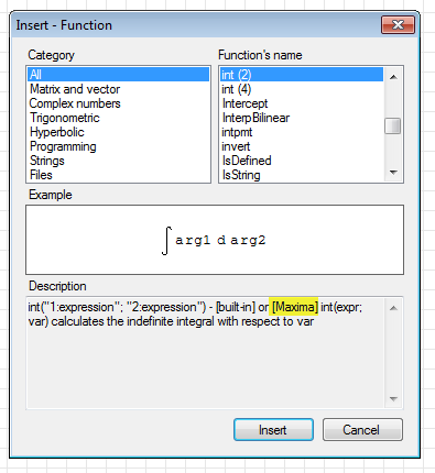

  • 0.97.5346 with Maxima Plugin:

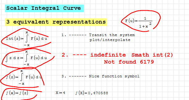

Does come with some of 68 plugins [6179] ?
The attached will rescue Smath 6179 new users.
Integral Curve.sm (11.95 KiB) downloaded 1299 time(s).

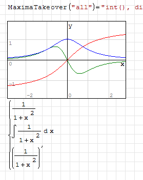

- Need hints on the usage of MaximaTakeover? -> Interactive handbook, see Toolbar -> [?]
- Want to plot derivative or integral of some functions? Here you are:
I am not a new user, but your example is way too advanced for me.
The magic of defining functions without using their formal arguments on the right hand side of the definition is beyond my comprehension.
