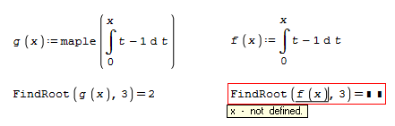

SMath solvers can't take an integral in the arguments, except al_nleqsolve.

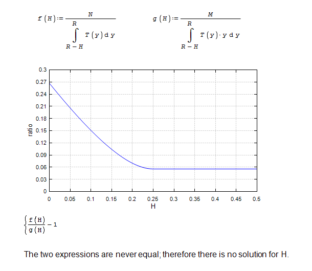

There are no roots!
