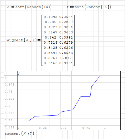

WroteI have a set of (x,y) data points (measurements, not generated by a function).How do I plot these as a line plot ?
Augment experimental data [X,Y], simply plot.

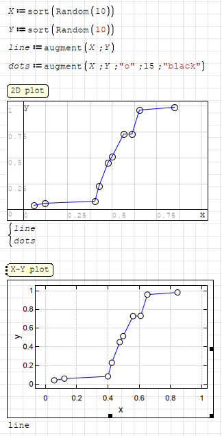

Next request: is there a way of showing the data points joined by lines on the plot?

WroteNext request: is there a way of showing the data points joined by lines on the plot?
You can either use a new plot for dots or feature of X-Y plot plugin.
Double click to X-Y plot, there is option for dots under;
Traces > Appearance > SymbolStyle > Type.
I generally prefer using 2D plot for its simplicity whenever I can.
Sometimes X-Y plot plugin is required nonetheless, especially on x + y functions.
X-Y plot can do anything 2D plot does, except the animations.
And X-Y plot plugin has many detailed customizable options.
You have much control over Axis, Title, Labels, etc.
Here is a sample for your request.
