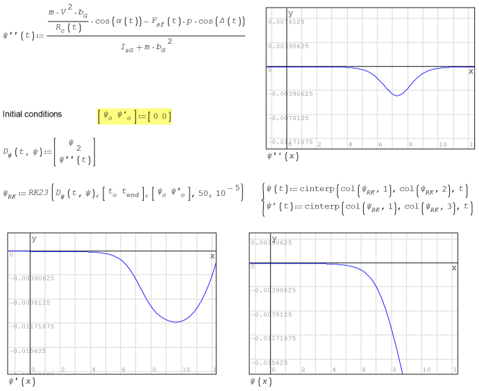

#32 Posted: 12/28/2019 9:59:18 PM
Hi, sorry if I bother you again. I'm trying to integrate a function, the function in question is psi''(t) in order to derive psi'(t).
You have phi in your document ... psi is a built-in function.
So, if phi''(t) is the 2nd derivative ... then the derivative
is simply the integral. To expedite fast: done discrete.
If you have questions: please re-post this document.
Cheers ... Jean.
PROJECT [1].sm (30.82 KiB) downloaded 1156 time(s).

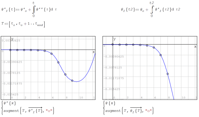

#33 Posted: 12/28/2019 11:19:45 PM
.... in fact you have PSI''(t).
Maple does not find an explicit integral.
PROJECT [1].sm (21.91 KiB) downloaded 1176 time(s).
#34 Posted: 12/29/2019 9:18:44 AM
... lot more maths in there.
PROJECT [1].sm (44.37 KiB) downloaded 1181 time(s).

1,139 likes in 1,805 posts.
I tried using Simpson and Romberg's recursive methods, but without getting a solution.
Where am I wrong?
PROJECT.sm (69.12 KiB) downloaded 1393 time(s).
Hi. You can use any Runge Kutta solver for integration.
Also, you can use SMath int procedure, but it's very (very) slow:
For the theory, remember that you can integrate (with definite integrals) both sides of an equation and get an equality too, which don't work with derivatives.
PROJECT.sm (74.9 KiB) downloaded 1409 time(s).

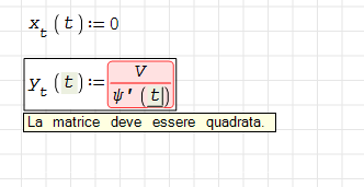

#36 Posted: 12/29/2019 11:21:10 AM
Ale16595
Ale16595
0 likes in 35 posts.
Hi, I have calculated the function psi '(t) through dn_GearsBDF.
But now I can't calculate the ratio in the picture.
The error says, "The matrix must be square"
PROJECT.sm (57.24 KiB) downloaded 1394 time(s).
#37 Posted: 12/29/2019 2:19:55 PM
Result from numerical ODE solvers is a data set.
Generate an interpolation scalar to 'x' ... then plot.
@ the end of the document ... more questions: -this one.
PROJECT (1).sm (74.9 KiB) downloaded 1389 time(s).
