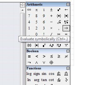

After you define h in terms of g and d is there some trick to show the rest or did you still manually input the function in terms of a, b, c, and d? When I input what you have for h and hit the equal sign again, it says that c is not defined. What I am trying to avoid is having to input the function in this way. If I were to change the function f I would want it to show up in the definition of h and not have to change every instance of it.
#4 Posted: 5/27/2015 10:01:31 AM
Nevermind, I just figured it out. The arrow is what I need to press instead of the second equal sign. Thank you very much for your help. This helps me out immensely!
