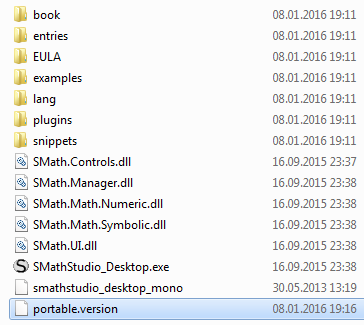

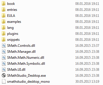

  1. Go in the download page and download the Desktop Linux version of SS
  2. Unpack/unzip the archive in a folder where you want (you can use 7zip or anything else - you have to do it twice, both for the gz and the tar archives)
  3. In that folder create a new empty txt file, and call it "portable.version" (you must have the "Hide extensions for known file types" option of your OS disabled);
    you can unzip this to make it simple portable.version.zip (166 B) downloaded 793 time(s).
  4. That's all, you have a portable* SMath Studio; launch it, open your files, download the extensions made for that version of SS. The installed version or other portable versions does not interact.
As additional precaution, do a backup of all your worksheets before working with the new version (this is always useful)
* The .NET framework must be installed on the system (like for the installable version), this makes the application not "fully portable"; this is why there's not an official portable version in the download page.

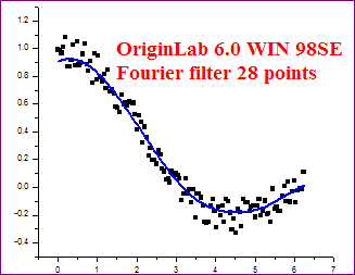

#10 Posted: 1/11/2016 12:45:28 AM
... here is my OriginLab Win 98 SE on XP running Fourier filter.
17 years old, fresh from birth day. Comments about OS to
run fft on Smath: I just don't understand.

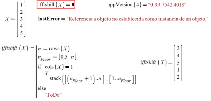

#14 Posted: 9/5/2020 7:39:19 PM
1,139 likes in 1,805 posts.
Hi. It's seem that there are a bug here, only for vectors, not for matrices.
#15 Posted: 9/6/2020 1:40:04 PM
Thank you Alvaro, I'll fix it ASAP
Alvaro 9/6/2020 6:43:00 PM
