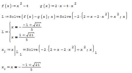

#5 Posted: 3/12/2019 8:35:59 AM
Johannes Piel
Johannes Piel
2 likes in 20 posts.

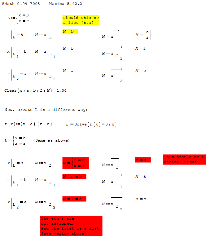

Here comes an image. This may show up differences with smath or maxima versions.

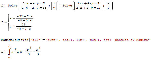

#6 Posted: 3/12/2019 8:51:00 AM
1,359 likes in 2,273 posts.
L is differently defined in the two versions (use the dynamic assistant by mouse hovering over the definitions to see the difference)
in the second case, L isnt't stored in evaluated shape, thus vectorize() doesn't recognise the expression as vector and executes the expression only once.
#7 Posted: 3/12/2019 9:24:44 AM
Johannes Piel
Johannes Piel

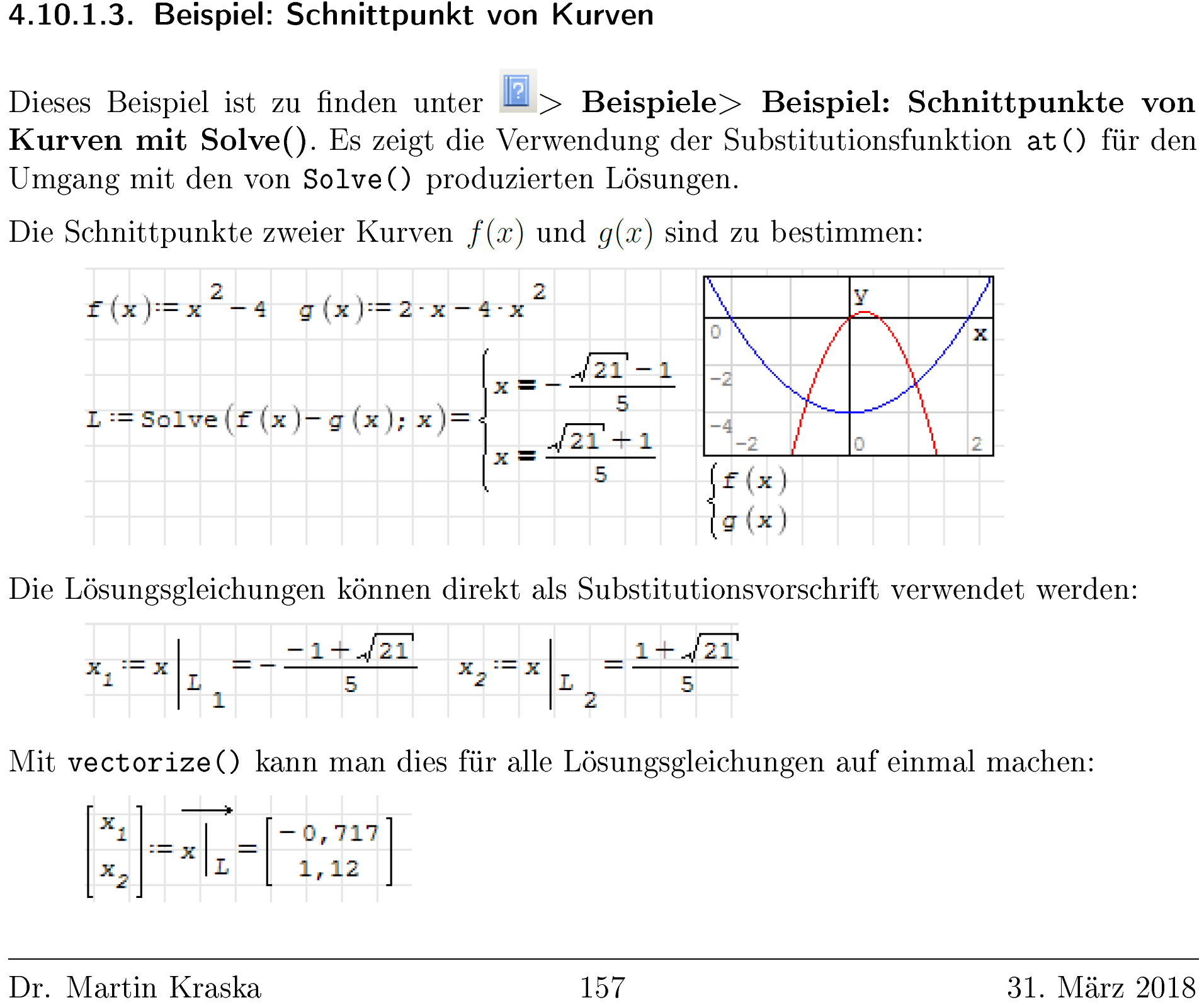

OK. I see.
But how can i get L stored in evaluated shape?
In your example:
it works nice.
If i try the same
it does not. Did i miss an configuration?

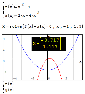

#8 Posted: 3/12/2019 10:19:30 AM
... plot first, solve(,,,,) native Smath.

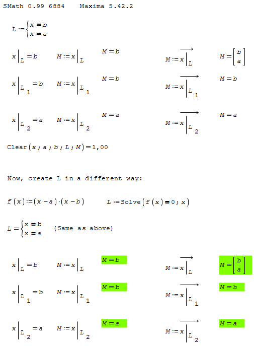

#10 Posted: 3/12/2019 11:40:18 AM
Johannes Piel
Johannes Piel
I found the difference between Program Versions.
I tried V0.99.6884 and all works as expected.
L is now assigned identically for both definitions.
The bug may be not located in at().
#11 Posted: 3/12/2019 12:21:16 PM
It seems that the evaluation logic in the plug-in interface has changed.
The function Solve() indeed shows a different behaviour (not evaluated/simplified when used in definitions, as if it was behind a line operator)
Other functions like int() don't seem to be affected by the problem.
Blatt39.sm (6.81 KiB) downloaded 1372 time(s).

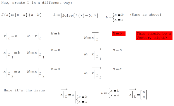

#15 Posted: 3/12/2019 11:45:34 PM
1,132 likes in 1,801 posts.
Hi. The line statement seems to correct all issues, except the vectorization one.
