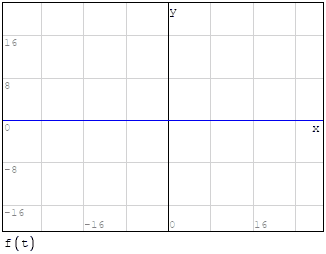

#1 Posted: 7/10/2023 3:41:34 PM
When I right click on the graph and try to animate, I get "t not defined."
test.sm (3 KiB) downloaded 1519 time(s).
#2 Posted: 7/10/2023 3:54:27 PM
WroteWhen I try to animate, I get "t not defined."
SS 6179 is more convivial:
"plot then define animation variable"
Click over the plot then set the animation, variable.
#3 Posted: 7/10/2023 5:54:10 PM
I right click on the graph and then select animate t.
I select 2 frames per second.
Still get error, t not defined.
