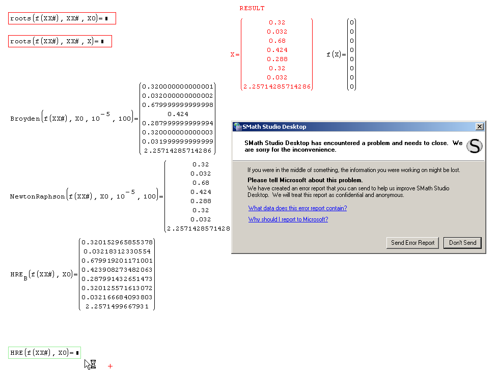

#44 Posted: 9/15/2012 2:38:11 AM
Thank you w3b5urf3r,
I put this on the Bugs forum including the Hang report. Hope that this will make any help to Andrey.
EDIT: Unfortunately, it crashes on Win7(64) and in Ubuntu for me as well. In Ubuntu "Stack overflow" error appeared.
Primer43-Ubuntu (53.11 KiB) downloaded 2391 time(s).
#45 Posted: 9/15/2012 6:24:45 PM
I've made some performance improvements inside HRE (the plugin is in this attachment), could you test if the bug is still present?

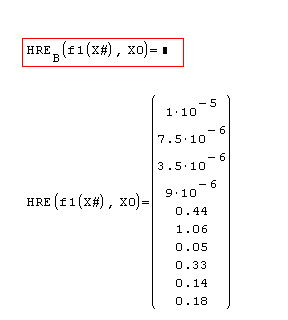

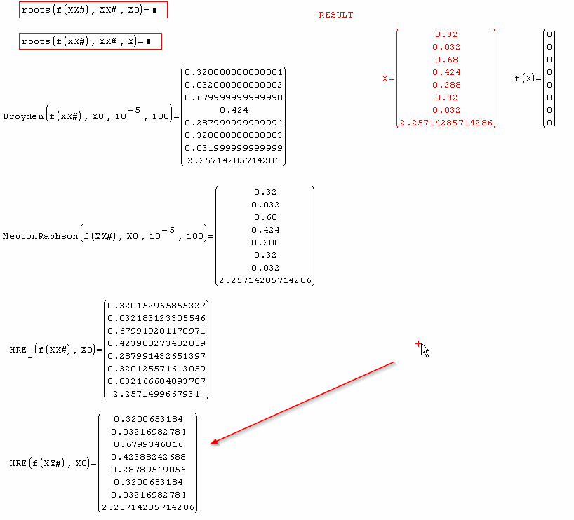

#46 Posted: 9/16/2012 2:06:14 AM
Hello w3b5urf3r
This is working now just great . Thank you very much
Find attached the pictures both from the WinXP(32) and Win7(64)

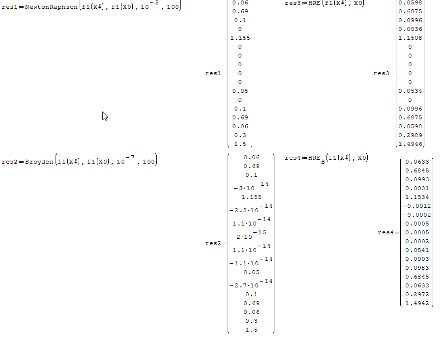

Hello w3b5urf3r, me again
I have to excuse my self but it seems you will not get rid of me so easily
Here is another of my teaching class files. It seems that HRE.B will have problems now. Anyway, it is a linear system again and NewtonRaphson based solvers did the job, Broyden was quite Ok but HRE.B failed now.
#48 Posted: 9/16/2012 6:12:37 AM
Hello w3b5urf3r
Great,
it seems that the number of nested iterations was excessive to handle, I just placed some eval here and there... :d
A first check show me that Broyden returns a wrong result, but I don't know why; comparing them with the snippet in the reference sheets (using γ:1) the script works fine... I'll check it a little more
EDIT: the snippet is wrong, use Newton instead of Broyden, so the results are a little bit differents but are both wrong (so I think that HRE.B() can't be used in this example...)

#49 Posted: 9/16/2012 8:22:27 AM
Hello w3b5urfer,

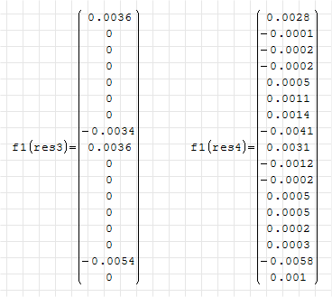

Here is another similar problem like the previous ones. This is a 17x17 problem. Again, problem is linear and solved with nonlinear solvers (roots() failed here). The results are quite good except the HRE.B gives a bit poorer results.
#50 Posted: 9/16/2012 11:42:18 AM
Hello w3b5urfer,
Hi omorr,
most likely both will be revisited...
actually HRE/HRE.B are based on the simplest algorithm that I've found, and seems that it's quite onerous (Broyden and Newton are both much more faster), so I think that Homotopy function (at the time, at least) should be used only for testing purposes or when both Broyden and Newton fails; consequently I've limited the CPU usage using this convergence criterion: f(x)<10^-2 with no more than 100 sub-iterations for each Homotopy iteration (no more than 1100=100x11 iterations for HRE and 2200=100x2x11 iterations for HRE.B).
BTW note that in both case the convergence criterion is met (see the attachment).
regards,
w3b5urf3r

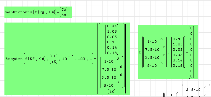

- New feature: solvers for systems of equations now accept multiple unknowns names (see the example below)
- Broyden convergence criterion revisited
- Plugin Jacobian(...) unlocked
NOTES:
- known starting values must be placed with reference to the alphabetical order of the unknowns (a,A,b,B,c,C,...,z,Z,α,Α,β,Β,γ,Γ,...). If you are unsure about the order, call the function mapUnknowns(1) (see the example below);
- Jacobian() generates derivatives, gradients or Jacobians depending on the type of arguments.
PLEASE REPORT ANY ISSUE

Hello w3b5urf3r
I was playing a bit with this test version, of course .
This feature you included if awesome
Broyden is working very well, just playing with tolerance, Decimal places and Exponential threshold - everything looks fine then (see the picture please ). I was just playing a bit with it, it seems quite good for this example except HRE.B gives different results with and without multiple unknown names - see the attached file please. Actually, no big deal about homotopy methods at the moment as you explained

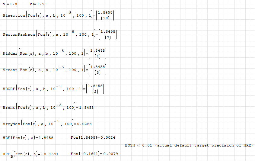

Hi w3b5urf3r and Radovan,
I'm delighted seeing your interesting work.
I tried to apply the plugin to one of my problems - one equation - here attached.
It is obvious that the ability of various algorithms is enough dependent on the initial guess.
I'm interested if you have some suggestions concerning the initial unknown guess strategy for this case, seeing the parameters variation ranges.
Thanks and congratulations again for your work,
Ioan,
longflamb eq.sm (29.49 KiB) downloaded 1720 time(s).

Hi Ioan
The HRE functions need 2 arguments, no more (see the attachment).
The initial unknown guess strategy It's a common issue, Homotopy and Bisection I think they are the best approaches.
Note that in your script a "large" bound it's better than a little bound.
best regards,
w3b5urf3r
