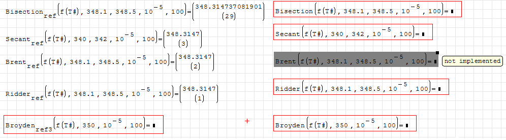

PLEASE REPORT HERE ANY ISSUE

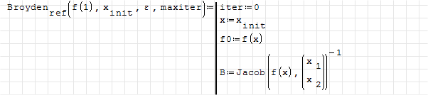

Here is a bit of testing the Broyden plugin. It is a clasical "driving crasy" situation with multiple solutions. It was mentioned by kilele in the link to the document http://en.smath.info/forum/yaf_postsm7678_solve---and-roots-----again.aspx#post7678
Your plugin failed (if I did not do something wrong) but do not worry about it - it is a common situation. The problem is why "Can not calculate" error returned. I do not know. My function returned another solution than few Newton-Raphson iterations or roots(). I also used another software that uses some kind of broyden algorithm and here is the result - the same as roots() returned

The function as in the *.sm file doesn't work because the first approximated inverse jacobian ( B ) is an Identity matrix... i've seen that is a common issue (f.e. root finding methods)... in SMath this could be fixed using the Jacob() function on the user input solution (see the attachment).
Unfortunately the function Jacob() (as well as other functions such as error() function) are not in the 4 standard libraries; I will try to see if importing the library on which it was made by Andrey can be implemented.

I would suggest you to strictly avoid using Jacob() inside Broyden - it will get new troubles. I really do not know what to use instead as a first Jacobian approximation. If someone have any idea, please help.

the algorithm is similar to that shown in the attachment (replace the B update definition to see the different behavior).

Wrotewow, have you used bisection as an initialization of broyden ?
also i've searched information about the broyden method over time and it seems the most advanced/recent version is a modification of Johnson's by Baran :
http://arxiv.org/abs/0805.4446
As for the Jacob() function, I thought that Broyden didn't use Jacob directly but an approximation..

Again since Broyden is not globally convergent, bisection might be interesting as an initial approaching to the roots
