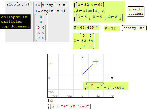

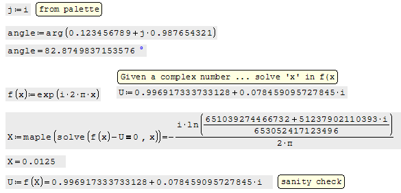

Show your example of complex converted to A*e^j*φ
