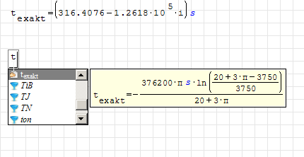

Dear forum member

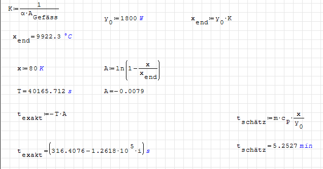

A result apears in a realy strang number format. If I calculate with my -T*A or -(40165*(-0.0079) I receive 317 without an appendix containing a i. How I can receive a similar result from Smath?
Kind regards
Gaselhul

In Smath as well: abs(316.4076-1.2618*i)=316.410116
Something is "koko" up above before calling =
