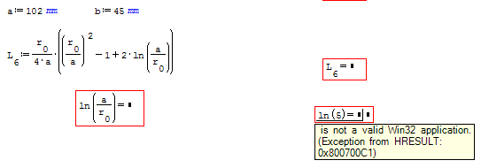

Please help! I am trying to do a simple natural log function and I keep getting the error " is not a valid Win32 application. (Exception from HRESULT: 0x800700C1)".
I am running v0.96 (build 4909) on Windows 7 x64.

if you have installed one or more WIN 32 plugin delete it, then it should work

Do you use the unofficial portable distribution? If not, you might give it a try.

I tried removing all plugins from my install, but that did not work. I then tried the portable version and it solved my issue!
Thank you so very much!
I had defined r0 above, I just forgot to move it down when I took the screen shot.

BTW I suggest you to follow the hint made by ioan92, sometimes something goes wrong with the installed version, a clean install can solve issues (tried myself this summer with an annoying red cross of death moving the vertical scrollbar)

Just a follow up. I have been using the unofficial portable version for a while now and it has been working as expected with no strange errors. Thanks again to all for the help!
