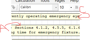

I'm assuming that the document mode is accessed via the button on the lower right next to the zoom spyglass. When I hover over it, Windows 10 as I never got the fonts fixed in Linux, it blinks like crazy and it's hard to select.
In addition, I ran into an issue trying to upsave some old files. I updated the font to Calibri and now the text in the descriptions do not match. New variables are using calibri and old variables that I carried over are still in Ariel

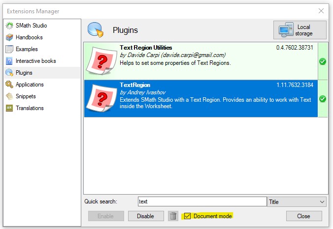

No. Quoting an instruction here from my first post:
Here is an instruction about how one can make Document mode enabled:
  1. Open Tools > Plugins..., find and select Text Region, set Document mode checkbox checked:
  2. Find a New document item in File menu:
It was decided to show all descriptions using monospace font with no regards to what font is set as default for the document. This was implemented few Months ago.

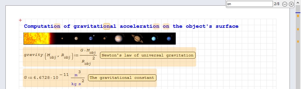

#28 Posted: 1/20/2021 8:57:00 PM
2,343 likes in 4,046 posts.
Important improvements in todays update: https://en.smath.com/forum/yaf_postst20114_Beta--SMath-Studio-0-99-7691--21-January-2021.aspx

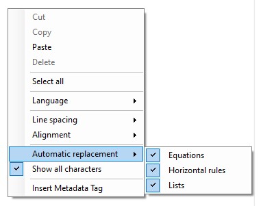

Search in text significantly improved:
Invisible symbols can be shown:
Automatic replacement can be disabled:
+ work with ordered/unordered lists significantly improved.

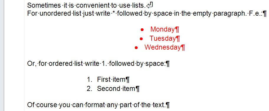

#29 Posted: 5/12/2021 8:44:16 PM
Copy from Worksheet to Document finally implemented:
It is also possible now to paste images from Clipboard directly to Text.
Of course it works in both cases: for Worksheet and Document modes.
