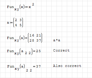

Typically I thing of a function as taking a value so I was curious what would happen if it took a matrix. See below.
Don't forget the xy subscript is just part of the name. Type Fun.xy. The element is accessed by the [ key. In the first case it was Fun.xy(a[2,2) and the second case Fun.xy(a)[2,2.
Have Fun.
Have Fun.
Ed
