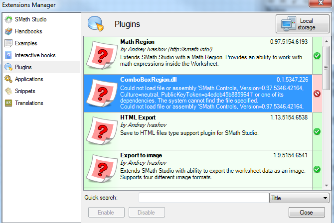

I have been using SMath for a while now, but have not tried any new plugins.
Today I tried to install the ComboBoxRegion, but it would not install. I now get an error message when the program loads. "Could not load file or assembly 'SMath.Controls, Version=0.97.5346.42164 ... The system cannot find the file specified."
I also downloaded the .zip file and placed the .dll files in the plugins folder. that did not appear to make it work either.
What might I be doing wrong that this does not load?
I also would like to know how to remove it from the list of Local storage plugins?
Is it correct to not see it in the Online gallery now?
I haven't tried any other plugins for fear that I can't remove them.
Any assistance would be appreciated.

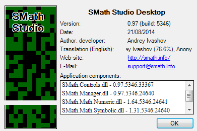

#4 Posted: 9/9/2014 1:38:14 PM
I just tried to update the program. It did not appear to install the update.
I then removed the program and installed the latest version.
0.97 (build: 5346)
8/21/2014
I now receive the following message when starting the program.
ComboBoxRegion.dll
That assembly does not allow partially trusted callers.
What do I do now???
Thanks for your help.
Jay
