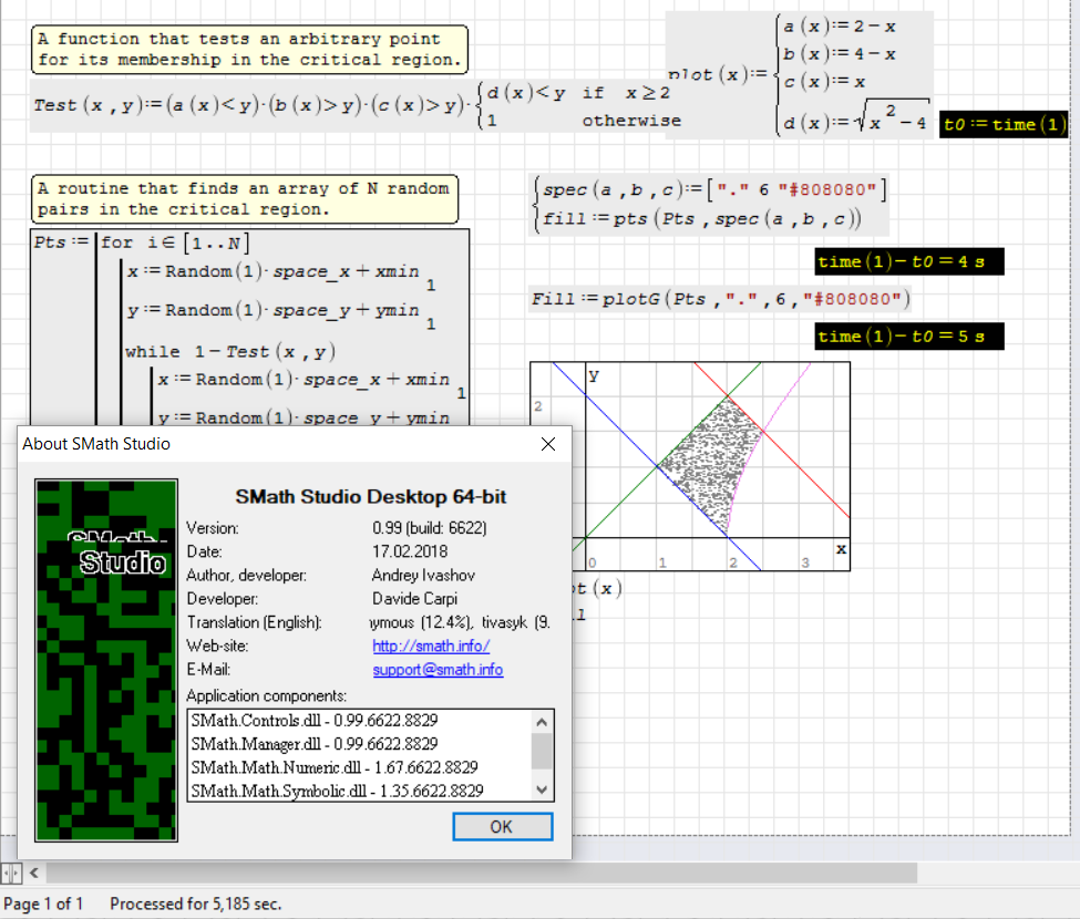

#1 Posted: 2/17/2018 11:19:44 PM
This refactored style is ~ 25 times faster than the very original.
The nested style does not ring a bell about specific use ?
Random_8 Fill Critical Region.sm (17.72 KiB) downloaded 1327 time(s).

#3 Posted: 2/18/2018 4:32:39 PM
2,343 likes in 4,044 posts.
Hello [USERLINK]Basile[/USERLINK].
It does not work in 6622.
It does work on my copy of 0.99.6622:
Tried different locales - everything seems ok.
Random(..) function is from Statistical Tools plug-in. Please check if this plug-in available on your PC.

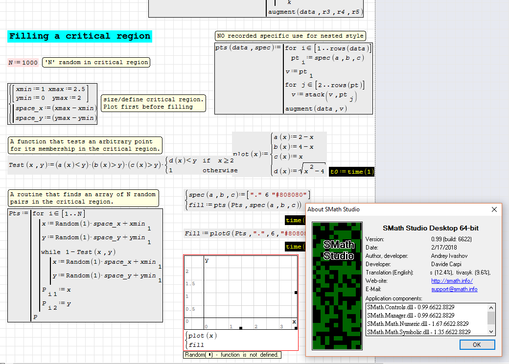

#4 Posted: 2/18/2018 4:49:32 PM
Basile
Basile
8 likes in 172 posts.
SMath-01.PNGHello Andrey,
Attached please find a print screen.
Am I doing something wreong?

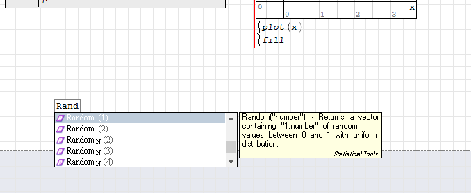

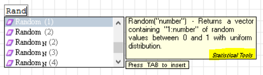

SMath-02.PNGIt looks that it is...
#7 Posted: 2/18/2018 5:21:15 PM
Please could you check what plug-in handles Random function in your case?
Also please try to test Random function... will it work in most usual scenarios on your environment?

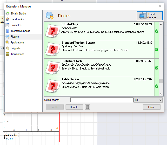

#8 Posted: 2/18/2018 6:45:09 PM
Basile
Basile
SMath-03.PNGHere it is...
And how do you want me to test the Rand, please?

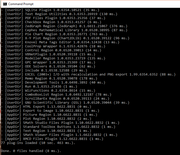

#12 Posted: 2/19/2018 2:46:31 PM
Not sure, but may be this is because of sort order of plug-ins or some additional plug-in which breaks the logic...

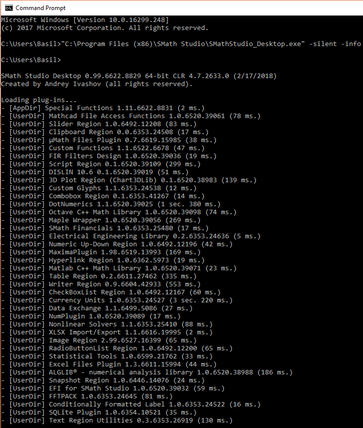

Please could you execute the following in command line? (path to SMathStudio_Desktop.exe may differ on your PC)
"C:\Program Files (x86)\SMath Studio\SMathStudio_Desktop.exe" -silent -info
I would like to see the output of this command in order to try to reproduce this on my environment.

SMath-05.PNGHere it is:

#15 Posted: 2/21/2018 3:59:05 AM
Thank you very much! Now I have everything to try reproducing this issue.
