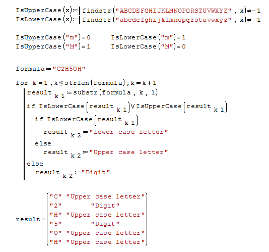

#8 Posted: 10/3/2010 3:05:18 PM
2,343 likes in 4,055 posts.
Hello.
Maybe this will help you:
(download source)
Note that this is only possible within SMath Studio 0.89.8 beta released today.
Regards.
#9 Posted: 10/3/2010 10:29:44 PM
oldhand
oldhand
0 likes in 3 posts.
Andrey,
Thank you very much. The two functions will definitely help. Just to understand how these things work, I tried to add a new function "IsDigit":
I think that I have now all the elements for my MW function.
Thanks again.
