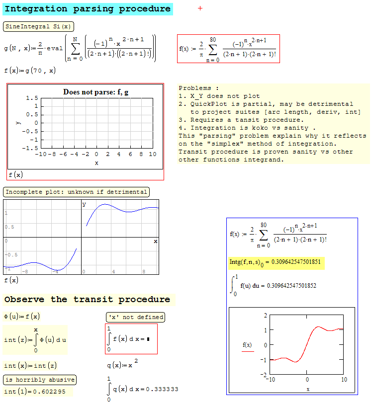

#1 Posted: 6/10/2016 12:02:11 PM
That one is for Designers wrt the latest Nightly build.
Done in Smath 5346 OFFicial release.
jean
Maths Integration Parsing Procedure.sm (23.92 KiB) downloaded 1229 time(s).

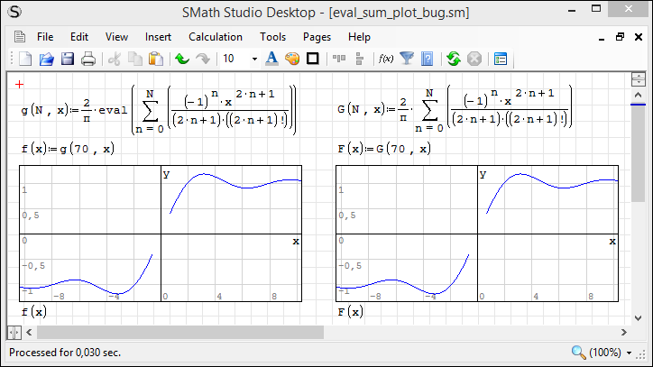

Jean,
Thank you! Fixed. And... if previous versions of SMath Studio required eval() function to be used, now it doesn't matter anymore.
eval_sum_plot_bug.sm (7.14 KiB) downloaded 1249 time(s).
