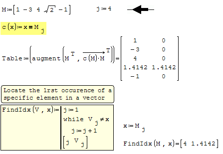

#3 Posted: 5/27/2020 9:03:55 PM
Also
(move the equal in the booleans from the leftmost addendum to the rightmost if you don't want to match zeros from the original vector as positive values)
frapuano 5/28/2020 5:09:00 AM
#4 Posted: 5/27/2020 9:56:07 PM
Truth table in more general, multi purpose.
Utilities Matrix Truth Table [Locate row_col].sm (43.62 KiB) downloaded 1030 time(s).

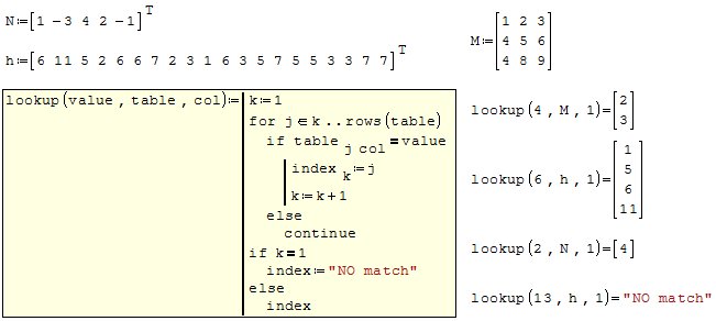

#5 Posted: 5/28/2020 1:53:56 AM
1,139 likes in 1,805 posts.
Hi. Another couple of solutions.
problem.sm (13.97 KiB) downloaded 1221 time(s).
