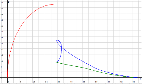

Hello to all.
I have traced these three functions, that depend on time, on the graph.
How can I insert numbered points, superimposed on the traced functions, so that the same numbering corresponds to the same instant of time?

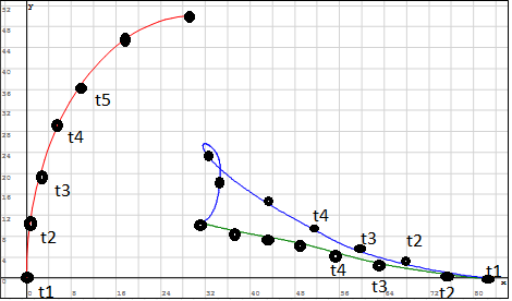

To be clear, I should do something like the following figure …

using some good tips posted by Jean, you could do this:
CALCOLITESImanovra_s.sm (78.32 KiB) downloaded 1120 time(s).
I preferred to refer to actual times and not to anonymous labels; however you can use the same methodology more easily
