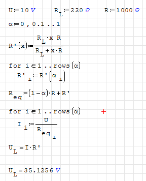

Why I am not getting output column?

You cannot divide by a vector. You must use a for loop. Also you must properly define a function with a different variable than the one you will use inside the function afterwards.
When I encounter issues in smath, I think it's best to put an equal sign after each step to show the result, it's easier to trace where the issues are.

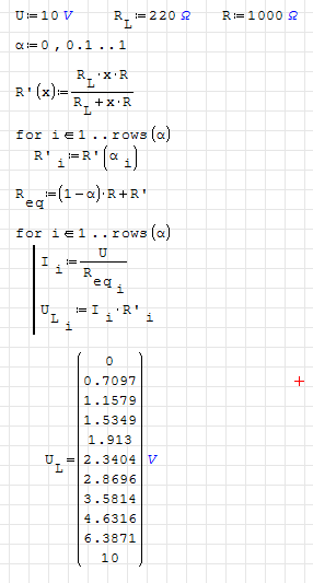

#4 Posted: 9/25/2015 12:56:26 AM
Ernesto
Ernesto
13 likes in 74 posts.
My mistake. I think this is what you were looking for.
#5 Posted: 9/25/2015 5:01:43 AM
Basile
Basile
8 likes in 172 posts.
Yes,
