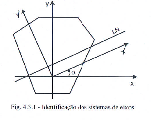

I'm writting a program for oblique flexo-compression and flexo-tension in reinforced concrete sections that generates the interaction diagram, but the calculation is very very slow.
I tried everything to spped things up a little, some modifications worked to some extent but the overall calculation time is yet completely impractical. I will try to explain a little how the alghorithm works and will annex the worksheet for those would dedicate their precious time trying to help me, to whom a thank very much in advance.
The program basically works finding the roots for f(ɑ;x.0) where ɑ is the incliantion of the neutral axis and x.0 is its depth relative to the uppermost point of the section, as in the image below.
Since it is a two variable function problem, what I do is that I use a loop to generate values of ɑ between 0 and 2π and then solve the function for each ɑ value to find its respective x.0 and then use the values of ɑ and x.0, using the secant method that I wrote myself because the interval where x.0 (the root) is not known and I need to make the interval larger in the case that the root is'nt in the first guess, to find the resisting moments of the section in the x and y axis and plot them to generate the interaction diagram.
As I said before I tried everything, changed the optimization to numeric, I put the whole program under a single line(), eliminated as much loops as I could, eval()"ed" the s**t out of everything, but it stiil takes more than 5 minutes to calculate using only 63 values of ɑ and I'm going to need much more than that for more complex sections. Plus, I will need to add more iterative routines for calculating the steel area for section with dual simmetry and things tend to get much worse.
So, I attached the worksheet and hope that someone will be able and willing to help me. Thanks in advance!

It is difficult to know when to use eval and when not, as sometimes it actually slows down the program. However, where you may always have to use it is with stack, augment, max and min. The code has a couple of those functions without eval, including a fairly hidden one where you put eval (max) -min, change that to eval (max-min).
Another detail to correct would be not to call f (x) so many times, because to extract f (x) [k] it actually evaluates all the lines of f (x).
There could be other calls to f (x) that could be stored in intermediate variables to extract its components.
In the main loop of the solver, try to evaluate f only once, in this case for xmid, instead of for x1 and x2, exchanging the values ​​of f1 and f2 when necessary.
Finally he takes the calculation of the flexures out of the loop.
Maybe an independent function for only the first component of f can speed up the process even more, but I don't know how linked the 6 variables of f are.
At the moment the fastest and most efficient purely numerical algorithm available in SMath for nonlinear systems of equations is al_nleqsolve. You can check it here.
This version is around 30 sec for the 63 steps.
FLEXO TRACAO E FLEXO COMPRESSAO OBLIQUAS CORRIGIDO 0.33 AFTER ERROR EVAL.sm (276.65 KiB) downloaded 1304 time(s).
