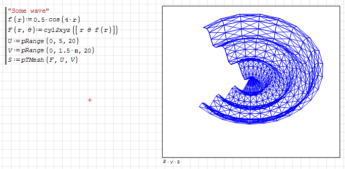

Hi. There are several variants for the triangular meshs. This is one.
pTriMesh.pdf (459.2 KiB) downloaded 768 time(s).
pTriMesh.sm (29.35 KiB) downloaded 1363 time(s).

Hi. Here are some notes about how the mesh is constructed. To include the missing vertices, they would have to be inserted at least twice, when drawing the diagonals. It could be done by constructing the mesh as it is, and instead of drawing the entire diagonal, to the center of the squares, but it could be a slow procedure. For another example, please see https://en.smath.com/forum/yaf_postsm74527_Offset-surface-creation.aspx#post74527
pTriMesh work.sm (28.8 KiB) downloaded 1321 time(s).

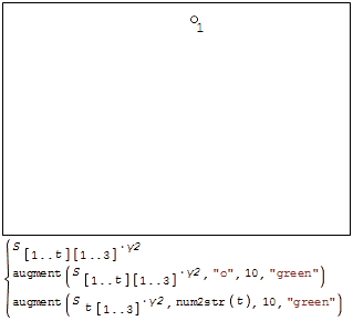

This other have the intesections as part of the mesh.
pTriMesh_v2.sm (48.39 KiB) downloaded 1353 time(s).

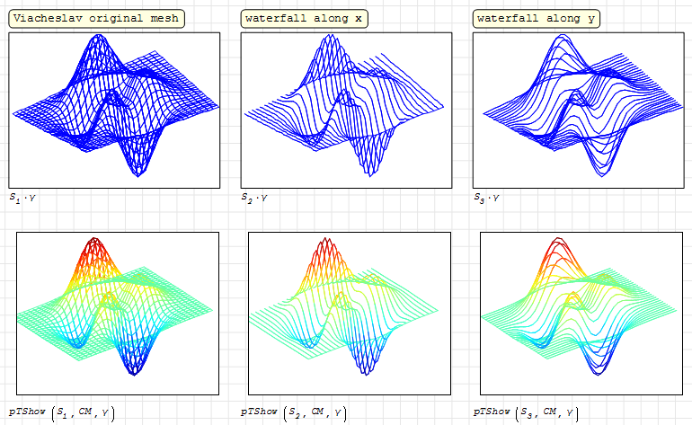

Hi. More general mesh utility, with a variable patern. Also, waterfall plots (matlab page here).
pWMesh.sm (193.8 KiB) downloaded 1345 time(s).
pWMesh.pdf (3.2 MiB) downloaded 816 time(s).
