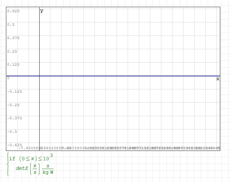

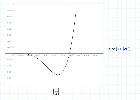

I'm trying to reproduce the attached plot (coming from MathCAD) in SMath
and I'm not able to obtain a plot of the function nor even dividing the function by
1E+10 - I suspect a pb dealing big numbers - by the way I have also an error trying to use MAXIMA GNU.
Has anyone some idea/workaround?
Many Thanks

Here attached the file so that you can see "hands-on" the issue.
For TMMT.sm (99.5 KiB) downloaded 1770 time(s).
I still suspect a limitation in plot function dealing with "big" numbers....but even dividing by 1E+08 (and even more...)
seems to work in this case (I made some other tests and, sometimes, this trick is useful).
As you understand I need a "visualization" of the function in order to "guide" the "solve" function (that seems
to work remarkably well w.r.t. MathCAD, by the way....but I cannot always be so lucky in this kind of problems...).

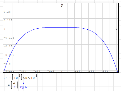

Thanks Overlord! First I tried to reproduce the image in your post: just ADDING the unit of measures (as I have always done in MathCAD...but evidently I have not learnt the lesson.....) something is plotted....so, additional question how do you add the line with conditional statement (if...) that, if I understand well define the window range (also very very interesting for my pb)?

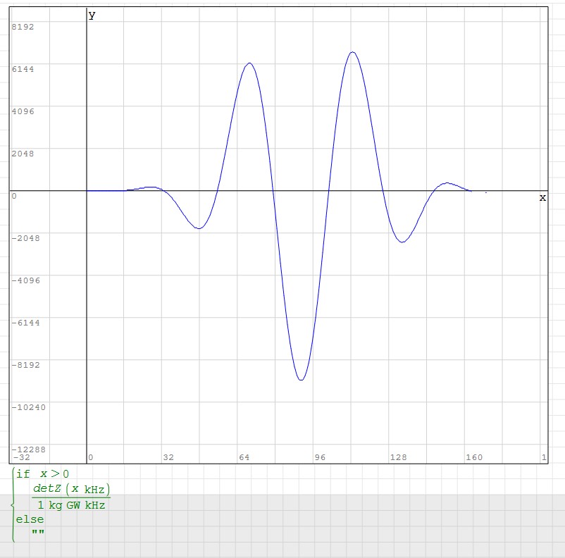

Hi. You can scale the plot choosing adequate units on it. With the exception of al_nleqsolve, there are not pure numerical solvers in SMath, but you can write your own one. It seems also that the limit for numerical evaluation of your function is about s = 160 kHz. Finally, it's true: native SMath plot can't handle very well long ranges, but XYPlot plugin can.

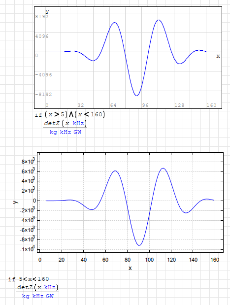

But once I combine the use of Plot native SMath function with unit scaling and range definition (as suggested and worked out by Razonar) and range definition...it works both with SMath native plot and with XY plot!!

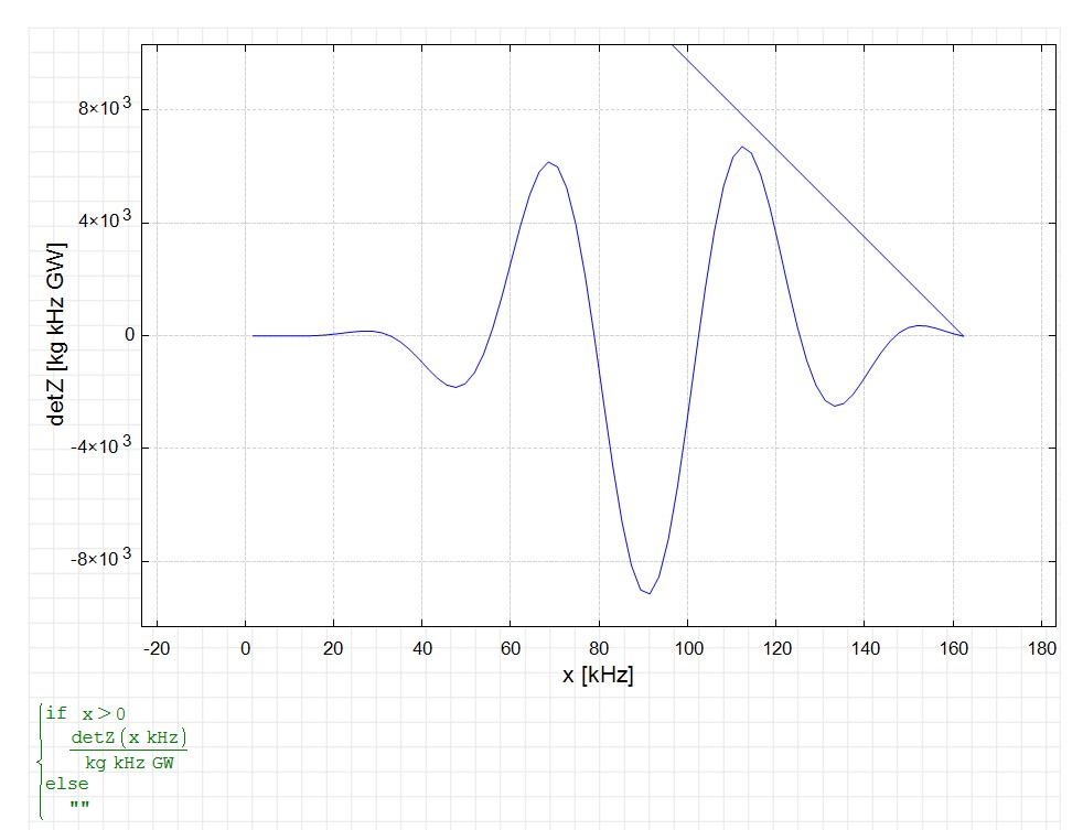

More, I tried to plot (with XY plot) the function for values higher than 160kHz; and, yes, something strange is happening for (see below); the same seems not using SMath Plot functionality
I asked that phenomenon to uni (author of XY Plot plugin).
It is caused by an algorithm to speed up plotting process.
If it really bothers you (it bothers me), there is a trick.
You can eliminate it by setting different start and end parameters.
