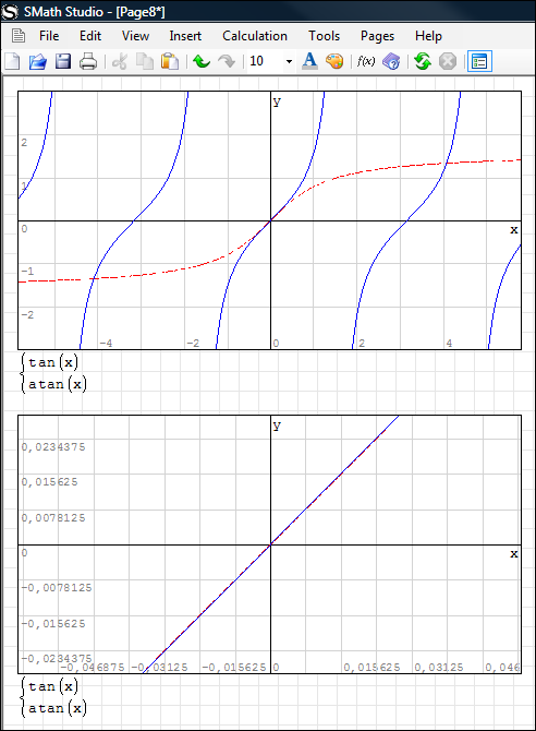

#4 Posted: 8/20/2009 2:59:52 PM
2,345 likes in 4,059 posts.
True.
Here is what I found also:
So, no problem there.
