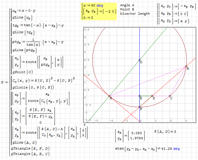

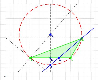

Trying to construct a triangle from an angle A, its bisector line h and the opposite side.

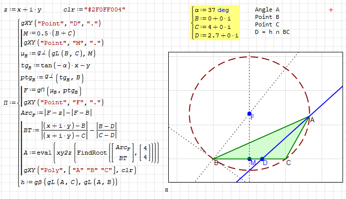

Hi. Something like this?
https://smath.com/en-US/cloud/worksheet/y2bVFCnr

I do not quite understand your reply on my problem (:triangle from angle A, its bisector h and its opposite side a). My intention was, that the value of h is given, but as far as I can see, you are using the intersection between a and h named D instead with a coordinate for D = 2.7+0*i. I can nowhere find a value for h, and likewise I do not see a calculation of the coordinate for D, so it seems to me, that it is the coordinates for D which you are taking for given in your solution.
Please correct me if I am wrong.

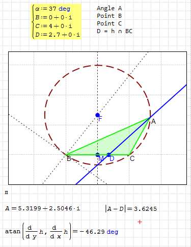

Hi. You're right, I don't show the final results, here they are:
I chose the intersection between h and BC because as given data because I don't know in which form you have the bisector: as length? as slope? The equation of the line h?

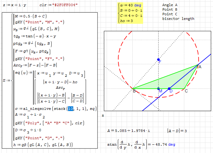

Answering your question, I define h (AD) as length.
If I use your numbers for angle A (37 degs), side BC (4) and the AD (3.6245) you have calculated from your chosen position of point D, I arrive at the same triangle as you do.
But, since I do not understand your approach, I wonder if I could challenge you to solve the following triangle (and referring to your drawing): angle A (BAC) 40 degrees, opposite side a (BC) 4 cm and angle A's bisector h (AD) 3 cm.

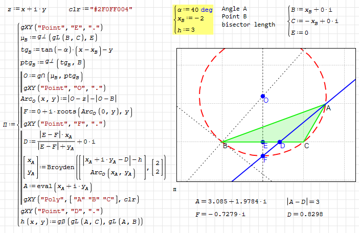

Hi Søren. This is a way for solve given the bisector length, depending of the guess value 1 or 10:
The red circle is the "arco capaz", in Spanish, I don't know how to call it in English (https://es.wikipedia.org/wiki/Arco_capaz)
Here an explanation about how to draw it by hand:
geom-scb-v2.sm (84.81 KiB) downloaded 1764 time(s).

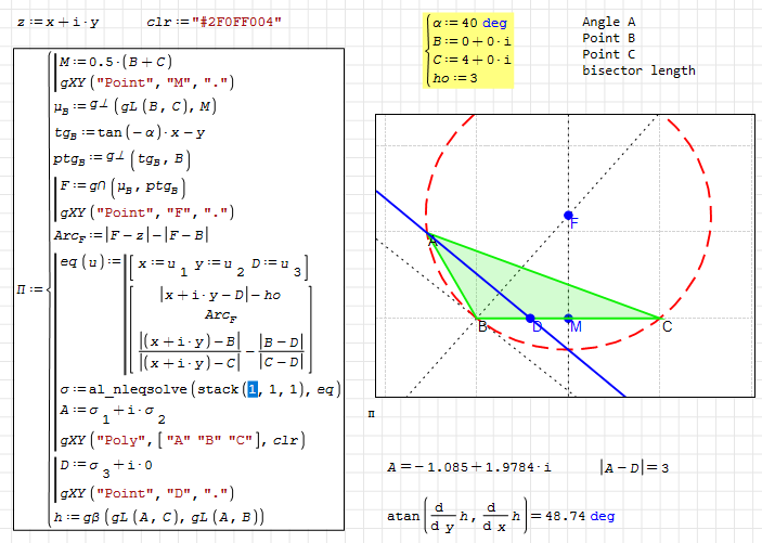

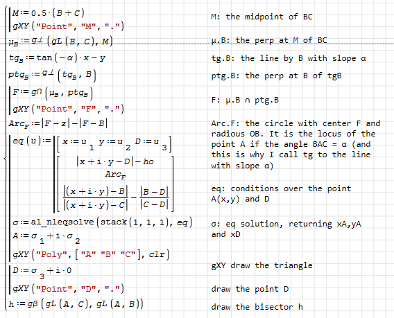

Hi Søren. Your geometry theory is more powerful than mine. Using your theorems, notation and coordinate system, this is a simplified version:
geom-scb-v3.sm (44.67 KiB) downloaded 1736 time(s).

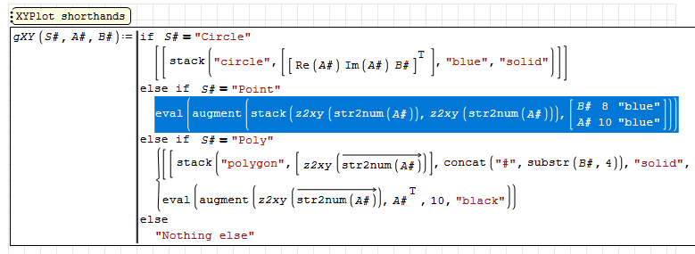

Hi Alvaro,
this is just a seek for clarification about your usage of the XY Plot because it is something new to me and it is very interesting .
To draw what is in the XY Plot module you write in Π a procedure that describe the steps needed to execute the drawing .
I was not aware that this was possible and moreover you use in Π the function gXY defined in the snippet area to execute/define some graphical primitives.
My question is where do you find info's that explain this method ? Can you add some detail on where this was documented in more detail ?

He creatively recycle examples from the first page of the description of the X-Y Plot component, which supports a several settings of tasks for drawing.

Ciao Franco. As Viacheslav says, I use the available elements according to their functionality. Also remember how line() works: it returns only the last value it has present, and can be used in many contexts, for example, in a table
