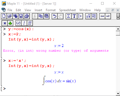

Hi. It isn't in other software, like maple. Usually it must to be an undefined name:

Still, I found that the integration variable is not quite independent (local) to the integral function.
Yes, like in Mathcad, in the wild domain of integration
Doctored in red, attached ... Cheers ... Jean
