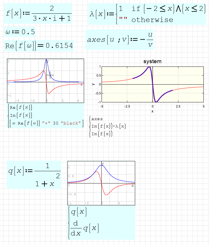

How to do it in SMath?
How to do it in SMath? - Messages

#2 Posted: 2/12/2024 10:44:45 PM
600 likes in 1,381 posts.
Natively, I don't know how it can be done.
Possibly you can't because smath symbolic engine is inferior.
Maxima can solve it. I assume maxima plugin can solve too in smath.
Maple plugin couldn't solve, maybe there is a trick I don't know.
#3 Posted: 2/13/2024 1:33:37 AM
As suggested ... remembering Imaginary is the Derivative
Worksheet104.sm (9.66 KiB) downloaded 1614 time(s). ... Please, let me know if working ... Jean

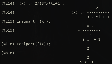

#5 Posted: 2/13/2024 3:58:14 AM
1,361 likes in 2,275 posts.
Maybe, Re() and Im() are worth adding to MaximaTakeover? Yet wrapping in Maxima() does the trick for now.
ReIm.sm (3.95 KiB) downloaded 1572 time(s).

#6 Posted: 2/13/2024 2:13:40 PM
Valery Ochkov
Valery Ochkov
67 likes in 713 posts.
I assumed so!
