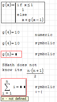

I am trying a simple recursion but without success. I always get the error of the function not being defined in numeric mode and just the first recursion step in symbolics. What am I doing wrong?
In the meantime I found a workarund but I am not sure if its intended to work that way. I add a line (]) and the I delete one of the two placeholders created (the vertical line will still be there) and then I type the function body in the remaining placeholder.
The failing of the symbolic evaluation with parameter n (even when using the sum symbol) is not a bug, I guess, but just a limitation of the symbolics implemented so far. But the error message should be a different one with symbolic eval, as n not being defined is not an error with symbolics. Guess it would be best if the expressions would simplify to themselves if SMath fails with a simplification (f(n) --> f(n)) without an error.

#2 Posted: 8/24/2013 2:58:59 PM
Hi rmix22
The line() is the correct way...
g(n) fails because the if/else statement can't evaluate what's the case, so can't return an output (if is numeric even if you set the optimization to symbolic); in the same way, if you do not define n, the sum can't return anything...
Thanks for the quick answer. Any logic behind this behaviour? I don't need that line add and delete placeholder with non-recursive functions.
Quote
Agreed, concerning the recursive function, as we don't have a way to tell SMath that we want n to be a positive integer (BTW, the assume modifier in Mathcad as so often doesn't work in this case either). But concerning the sum operator SMath could know the result (as does Mathcad) because there should be an implicit assumption of n being an integer.
Thanks for the reply.

#6 Posted: 8/24/2013 6:18:10 PM
If you replace if() by boolean expressions, then symbolic or numeric evaluation will crash smath. This is possibly due to lack of recursion stopping.
I can confirm, the function should returns an error due to infinite loops (because - correctly - all functions' terms are evaluated, so you fall in a infinite loop)
Don't know, the recursivity on plain functions doesn't work anymore, but I don't know why and from what happen; the line() function enable this feature.
I agree, BTW the symbolic engine have several things to improve
I wouldn't had expected that function to work being an infinite recursion. Maybe future versions of SMath will be able to detect an overflow or infinite recursion before the program crashes which of course should not happen.
I could image that your function works if you change the order of the factors in the last product. This would require that SMath had implemented some sort of shortcut evaluation (the second factor would not be evaluated if the first one is already identified as zero). But I just tried and this seems not to be the case.

If you replace if() by boolean expressions, then symbolic or numeric evaluation will crash Smath. This is possibly due to lack of recursion stopping.
I wouldn't had expected that function to work either but as I already wrote in my reply to Martin it could with a slight modification if SMath had implemented shortcut evaluation.
