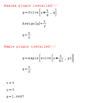

#5 Posted: 4/23/2014 4:00:27 AM
1,442 likes in 2,933 posts.
You can get plugins from the Extension Manager ( Tools > Plugins > click on "Local Storage" > "Online Gallery" )
Plugins are downloaded and stored in your %APPDAT%\SMath\Extensions directory (the Plugins folder in the program directory is only for built-in plugins)
Be careful in the description of plugins; if are for 32bit systems and you have a 64bit system you may need to use a modified version of SMath.
