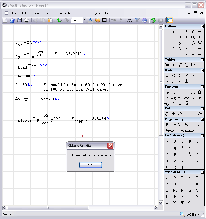

When I try to save a simple page it crashes SMath with a "Attempted to divide by zero." error. I got this error with the portable and installed version. The page works great until I try to save. I have attached a screen shot.
Thanks,
Kyle

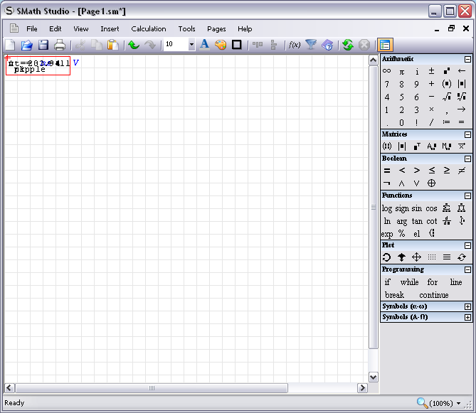

Thanks for the sample file. It does not open correctly for me. When I double click your file, I get what you see in the attached screen shot.
Thanks,
Kyle
EDIT: I get the same problem below from your file in both installed and portable version.

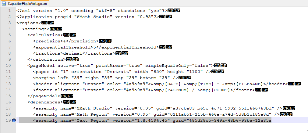

The file is broken - probably becasue the "Attemted to divide by zero" error has stopped the saving routines, but I'm not sure because last line is in the file header (TextRegion plugin), not in the body...
The kilele file works for me; if both install and portable versions cause you issues you can try to install again the .NET framework 2.0 libraries. What OS are you using? Windows XP x86/x64 SP1/2/3?

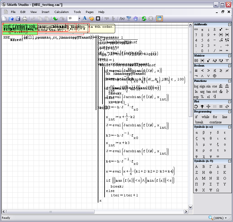

I've noticed that if you delete some dlls, a reconfiguration window is brought up by SMath and the files are restored, I assume they are extracted from the program's exe. As a last resort, apart from upgrading .Net20, you may want to replace some files from your installation with these of mine:
Your plugins directory had tons of files which mine did not have. I extracted your and told Winzip to overwrite mine. Then I noticed you included some .sm files in the plugins directory. I opened the larger one in SMath, which you can see in the attached.
