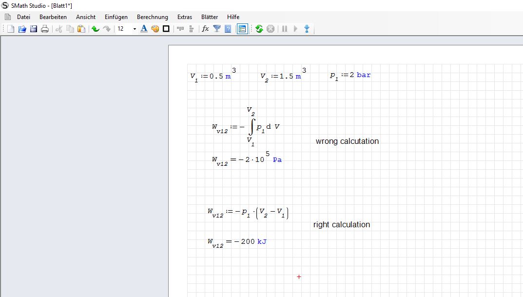

the Integration function doesnt seem to work in the right way.
#2 Posted: 1/31/2019 12:36:16 PM
1. Integration is over an integrand, here you have a constant
2. Squeeze the math regions, capture those regions to reduce the image
3. Doctoring is best with the work sheet.
#3 Posted: 1/31/2019 1:09:57 PM
... the Smath integration operator is Simpson.
id: it ranges from very accurate up to 15
and ranges from absolute crap !!!
That suggest the WS for doctoring.
Maths Beginner_2 [ln(x), exp(x)].sm (38.02 KiB) downloaded 1184 time(s).
