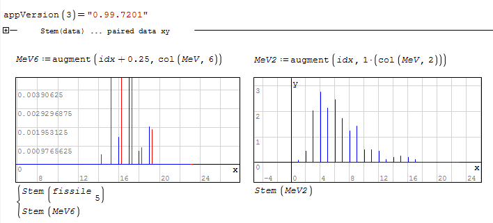

By same token, does it run correctly the Fission project ?
It failed previous SS 7109.
Project Fission.sm (166.12 KiB) downloaded 1727 time(s).

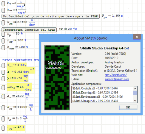

it omits showing the description of the variable.

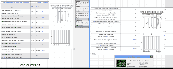

In the Tables, it does not respect the settings given in any previous version.

BTW Carlos: Fission is OK or red like 7109 ?

WroteIt seems that this new version of Smath Studio has several problems, for example sometimes
Thank you! Fixed here: https://en.smath.com/forum/yaf_postsm59417_Beta--SMath-Studio-0-99-7201--19-September-2019.aspx
WroteIn the Tables, it does not respect the settings given in any previous version.
For now it is all that I have found
I will check Table Region today.

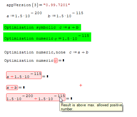

this problem triggered another one regarding the small numbers.
I am still quite puzzled with this. Especially when you are trying different optimizations???

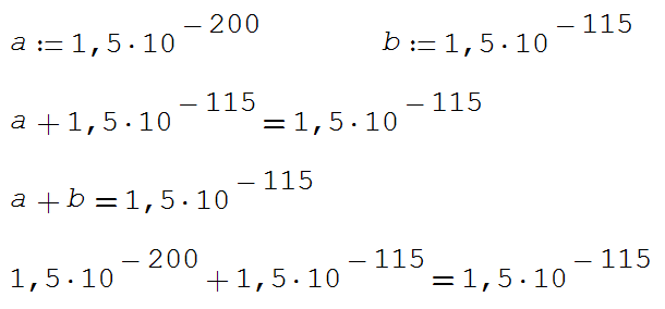

Best Regards,
This was fixed today. New version will be available in several hours.
WroteI will check Table Region today.
I've checked TableRegion and see that it uses
Hello Jean
Fision is Ok also in 7202
WroteWroteI will check Table Region today.
I've checked TableRegion and see that it usestag to store data which is restricted as SMath Studio uses this tag for its own purposes. I've implemented a workaround to the logic of opening files to allow TableRegion work with tag but I can't guarantee that this workaround will continue working in future releases. So, it is pretty important to switch plug-in to use another tag name for its purposes.
Hello Andrey
Thank you very much, now, the function Show description and Table, work very well in version 7202
