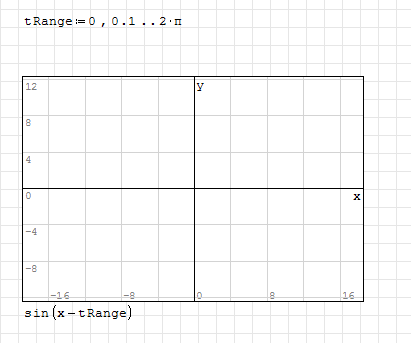

this simply animation (the same of Andrey video tutorial) doesn't work for me; 20 seconds of calculations and then... nothing!
Can be related to the recent installation of Microsoft Visual C++ 2010 x86 Redistributable 10.0.30319? (required by GNU Octave)
here is the file:
animation.zip
#2 Posted: 4/23/2012 4:01:42 AM
When using animation there is a dedicated variable "t" besides "x" and "y". Therefore, you should use "sin(x-t)" in your plot pointing by right click and choosing "tRange" with Animate option .

it works!!!
thank you!
