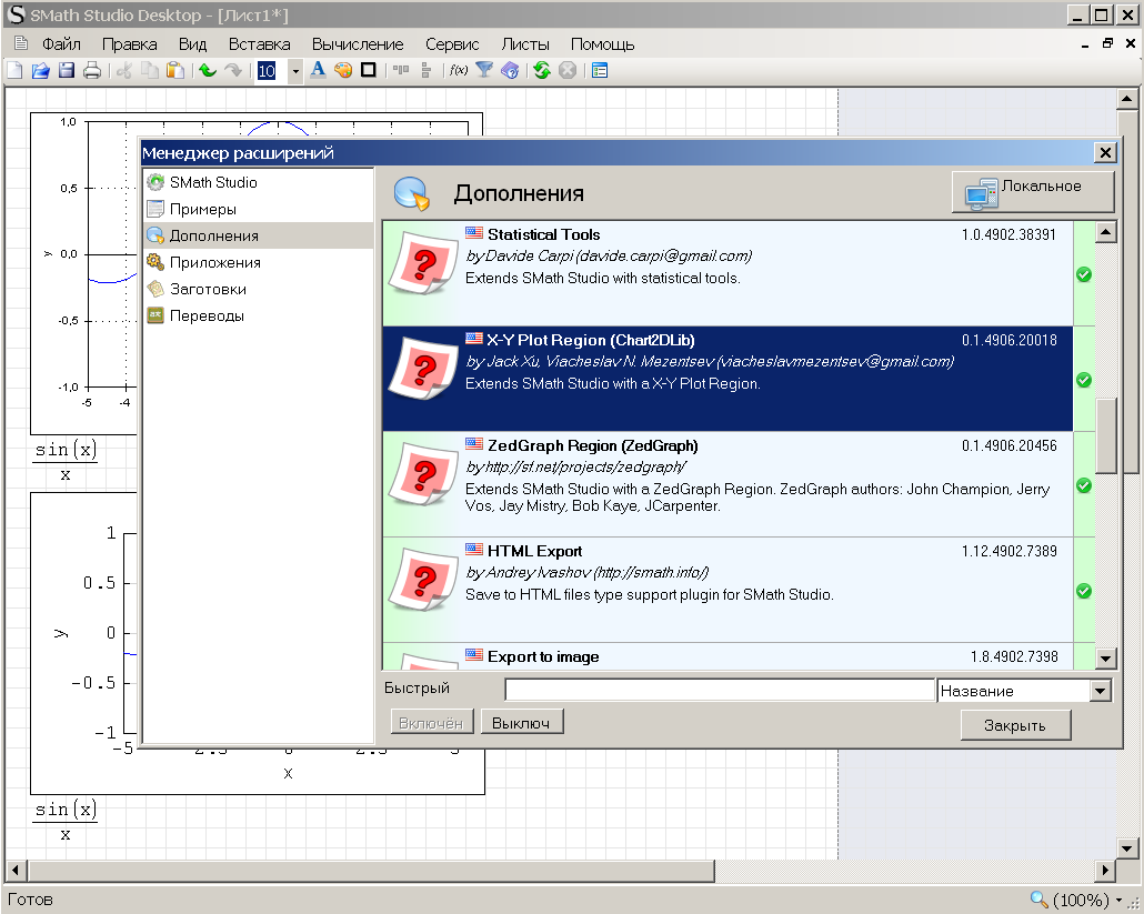

#3 Posted: 6/8/2013 6:06:21 AM
1,547 likes in 1,861 posts.

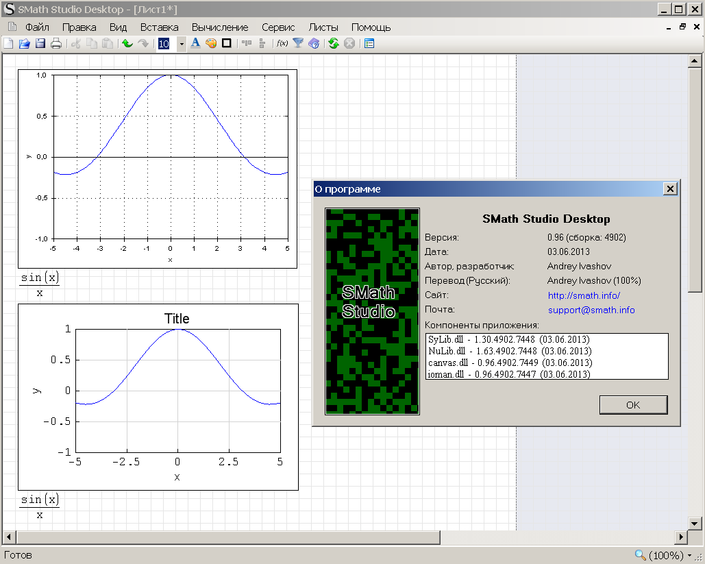

You can't use the old plug-ins with the regions. Therefore, a simple copy of the old version will fail. Do not use this way for old such plugins. As I said, they need to be recompiled with a small addition. New plugins can be copied. Do not use the plug-ins from my ftp, they are all old. Plugin Manager is not completed yet, Andrey is working on it. In any case, if there is a problem, try to remove all user's plugins manually from ..\SMath\plugins and ..\AppData\[username]\SMath\extensions\plugins, then install them from the gallery.
As for me, everything works fine:

#4 Posted: 6/8/2013 6:21:40 AM
For me as well
There is still already mentioned problem of saving graphs and the graphs settings. Am I right about it?

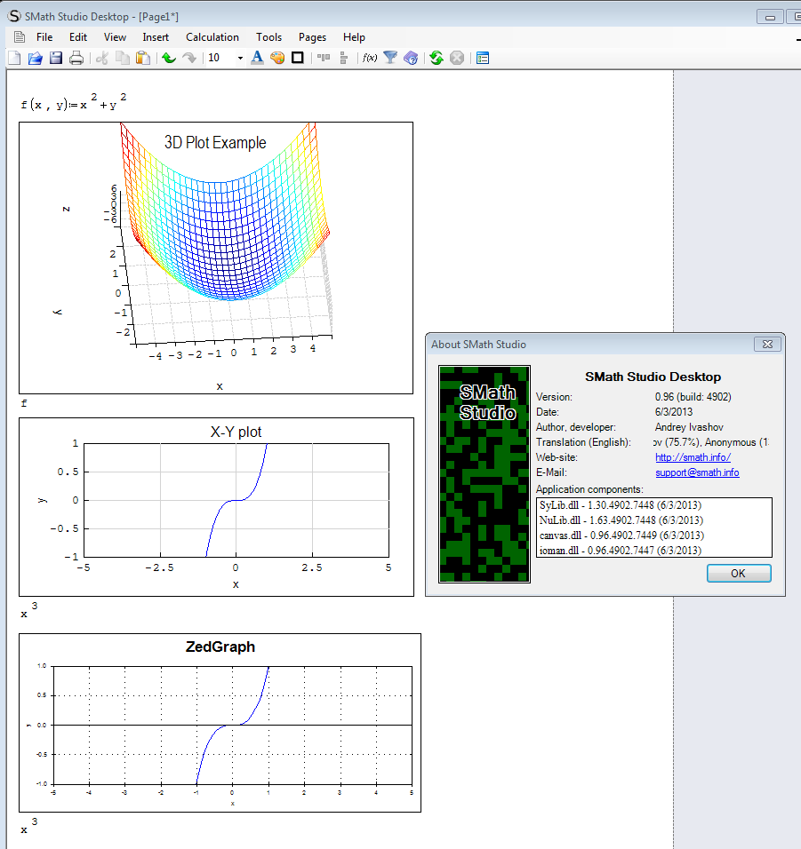

Uni, thanks for the answer. I can just envy you and Radovan the neat work of the plugins in the new SMath version. I am using the portable version of 4902 for testing. I just now removed the complete extensions folder (residing just besides the portable exe) and re-installed everything from the extensions manager. Thus, no manual file copying.
What fails to install (and needs to be removed manually for clean program start)
3D plot region
XY-Plot
Zedgraph region
What installs successfully (without function check, just loading)
alglib
checkbox
combobox
customFunctions
imageregion
MapleWrapper (with the files being installed in subdirs of extensions/plugin and also in extensions/plugin directly)
Statistical tools
