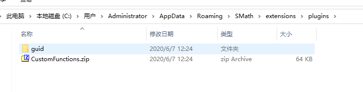

is there something wrong, i cant install any plugin. when i install plugin the smath will close by itself
#24 Posted: 6/5/2020 12:36:11 PM
Try this:
  1. Open a file explorer window and in the address bar type %APPDATA% and hit enter
  2. Find the SMath folder and rename it (f.e. SMath_old)
  3. Launch SMath Studio and check if the problem is solved
#25 Posted: 6/7/2020 1:30:00 AM
Jacques CHEN
Jacques CHEN
0 likes in 11 posts.
Try this:
I tried it, but it didn't work. I opened %APPDATA% again,like this picture. I think is some problem about uuid.
