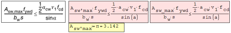

Surely I have not been able to explain the interest of defining a variable in such a way. Enclosed is an excerpt of EN1992-1-1 (Eurocode 2 - Design of Concrete Structures), where you can find several cases where the variables have subscripts separated by commas. The interest would be to keep the original variable naming/definition so that it would be imediately reconizable by anyone familiar with the standard/subject (other piers, licencing authorities, clients, you name it).

Directly, you can use only the decimal symbol in subscripts (whatever is the one set in your SMath Studio).
To add a generic symbol you can use CTRL+K or CTRL+SHIFT+K and switch to the special characters mode; this however isn't localization aware, thus if you share your document, something like the one below written for comma as arguments separator and period as decimal symbol, will stay in this way even for who has f.e. comma as decimal separator and semicolon as argument separator.
I think that following the path of special characters and fields, would be possible to introduce something like /./ and /,/ as serialized placeholders for localization-aware decimal symbol and argument separators inside strings; the way to input them obviously wouldn't be CTRL+K (because you might want an immutable comma/period) and neither direct typing (because argument separator is required to create new arguments inside functions).

As an engineer I use the Eurocodes all the time. In Smath I always use the underscore "_" instead of the comma "," for the definition of variables, as shown above in the post of Jean:
Asw,max → Asw_max
because it is the easiest / fastest way of typing, without the risk of making fault formulas.
And I had never any complaints from anyone who checked or commented to my calculation reports for this way of typing.
Regards, csb
