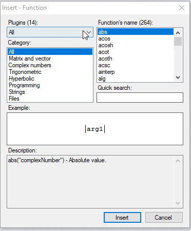

#4 Posted: 3/20/2019 8:05:07 PM
1,442 likes in 2,935 posts.
go to insert > functions... and play with the plugins dropdown to see what functions are carried by each plugin, also by Special Functions
#5 Posted: 3/20/2019 9:42:25 PM
dio pants
dio pants
16 likes in 180 posts.
Kinda like this.....
